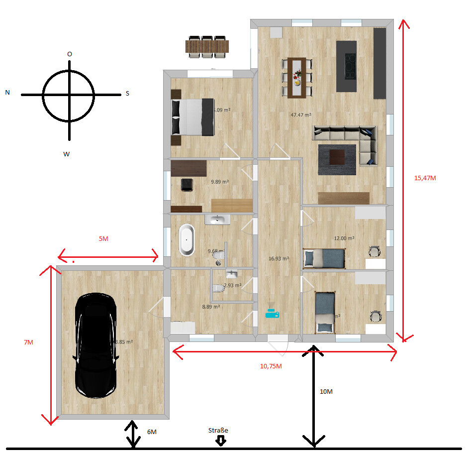

we are planning to start construction in June/July. Our architect is currently working on the drawings, so I wanted to join here and ask for your ideas or suggestions to improve my floor plan. At the moment, there are no dimensions included because it's purely about the room layout right now. Does anyone have an idea how to reduce the hallway from 16/17m² (172/183 sq ft) and somehow gain a bit more living space for one of the rooms? What else could or should be optimized in the floor plan? As soon as the drawings are ready, I will upload everything here and keep you updated throughout the build. A lot of the work will be done by ourselves.

So I have the garage exactly where the neighbor has theirs. 😉
And the terrace exactly where the garage provides privacy from the south.
Could you also share the dimensions of your first draft? Length and width.

the Scanhaus Marlow Marlow 147 BI like that one too.Thanks, Erwin93. A 5 m (16 ft) wide garage is too narrow. I'm glad I built mine 7 x 7 m (23 x 23 ft). That way, there is plenty of room for e-bikes and much more.

I would rotate the bungalow and rearrange the layout
A 5m (16 ft) garage width is unusual. Too narrow for two cars, barely comfortable for oneThe garage should also have space for a workbench and a small tool cabinet.
Have you taken a look at it? Scanhaus Marlow Marlow 147 B
On the west side, there is a carport directly adjacent to the street, and on the north side, the building boundary is right next to it for two cars (5m by 5m (16ft by 16ft)) plus an additional parking space of 4m by 5m (13ft by 16ft) to make full use of the allowed 9 meters (30ft).
