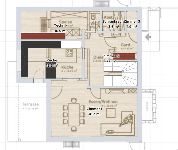

First, here are the site plans: (public roads marked in green. There are two roads adjacent to the plot: on the east and south sides.
Here is the section through the building: We are also considering leaving the attic open so that one can see up to the roof ridge and use the exposed beams as a design feature. Note the lower basement that clearly serves a utility purpose.
Now the floor plans from bottom to top:
Basement:
Ground floor:
Upper floor:
Attic:
Now I look forward to your comments and am ready to answer any questions. If I have forgotten anything important, I will add it later.

wiltshire11 Jul 2025 18:31KJaneway schrieb:
850,000€ is kind of an emotional limit for us That’s a nice term, suggesting a certain practical flexibility.
Walk-in closet opening from the hallway. If a walk-in closet, then exactly like that.
KJaneway schrieb:
We’re still considering whether we really want the pantry or if we’d rather invest that space in the kitchen. The pantry has become popular again. I would prefer the larger kitchen. The building’s appearance would also benefit if the kitchen were a bit bigger and there was a balcony above it. However, that would not fit the budget.
KJaneway schrieb:
To be honest, we have only discussed the interior layout with the planner so far and have somewhat neglected the exterior views. Planning a house from the inside out is one of several good approaches. The room layout, especially on the first floor, is very pragmatically solved. The planner placed the windows symmetrically on the outside. Apart from your preference not to have floor-to-ceiling windows, it’s worth considering whether the windows could be wider and whether, from an interior perspective, the symmetry is more helpful or more limiting.

Here I am again,
I measured the ground floor to see how the utility room could be accommodated efficiently. In doing so, I realized that the indicated platform staircase does not have the roughly required length of 3 meters (10 feet).
Have the architect check this again. As a starting point, here is my unfinished rough draft for the idea of placing the balcony on an extension.
@nordanney is right when he says that an additional 10 square meters (or even 20 square meters) won’t really be noticeable in the garden.

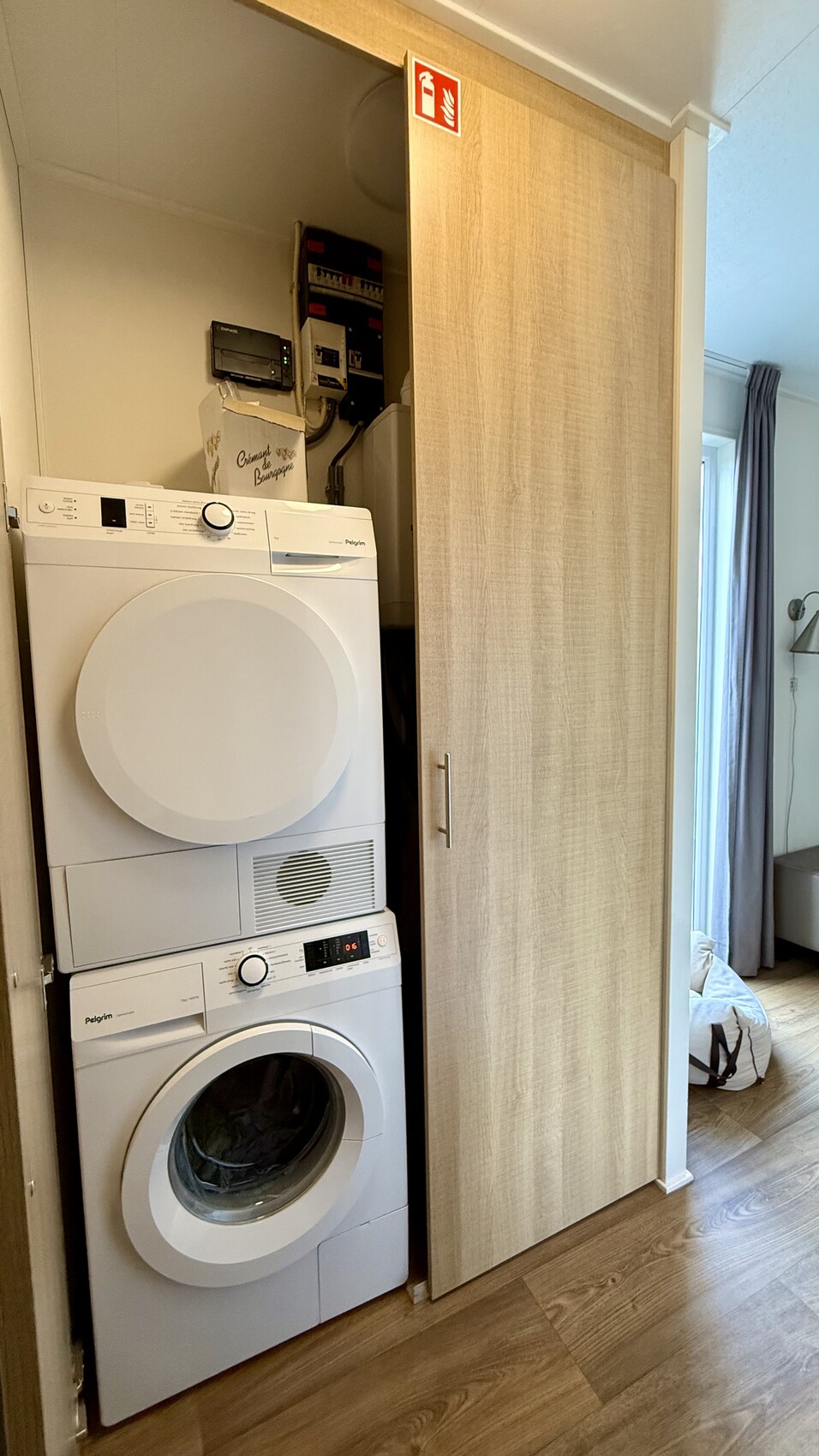

…possibly place a washer/dryer stack if going up and down becomes too annoying.

The pantry has become a modern trend again. I would prefer the larger kitchen. The appearance of the building would also benefit if the kitchen were a bit bigger and a balcony created above it. However, that wouldn’t fit the budget.Yes, the extension with a balcony on top is something I keep thinking about. The balcony could either run along the entire length of the house or be just above this extension. So far, it also serves as shading for the terrace, but that could possibly be solved with a sun sail and/or an awning. I can also easily imagine a large kitchen without a pantry. Nowadays, you can create smart storage solutions in tall cabinets. The larger kitchen appliances that are only used a few times a year don’t need to be kept close to the kitchen.wiltshire schrieb:
The division of space across almost four floors means that neither inside nor outside will create a sense of spaciousness in this big house. For me as a builder, that would be a dealbreaker.Currently, we live in a rented terraced house of 170sqm (1,830 sq ft). The space is spread over 3 full floors, so roughly 55sqm (590 sq ft) per floor: Ground floor: living room 40sqm (430 sq ft), storage: 2sqm (20 sq ft), kitchen: 9sqm (95 sq ft), hallway: 3sqm (30 sq ft), guest WC: 2sqm (20 sq ft)
Upper floor: master bedroom approx. 22sqm (240 sq ft), bathroom approx. 12sqm (130 sq ft), child 1 + child 2: each 11sqm (120 sq ft)
Attic floor: studio approx. 40sqm (430 sq ft) + balcony + heating room (2sqm (20 sq ft)) + storage room (2sqm (20 sq ft))
It’s a very tall and narrow house. At least we know what we’re getting into.

@nordanney is right when he says that 10sqm (100 sq ft) more or less (or even 20sqm (215 sq ft)) won’t make a difference in the garden.We discussed again over the weekend: a basement is definitely a requirement. Whether new or existing, we still have to examine. It would be nice to simply build on top of the existing basement. We need to see if two full floors are then possible. Above all, we have to have one or two experts inspect the basement first. We don’t want storage spaces scattered everywhere. Yes, it might become a flea market asylum. But in our current life situation, we won’t be able to address any collector issues.ypg schrieb:
Have the architect check that again. As a start, here’s my rough unfinished draft for the idea of placing the balcony on an extension.We will do that. The last thing I want is a custom size with smaller steps or steeper stairs.Arauki11 schrieb:
