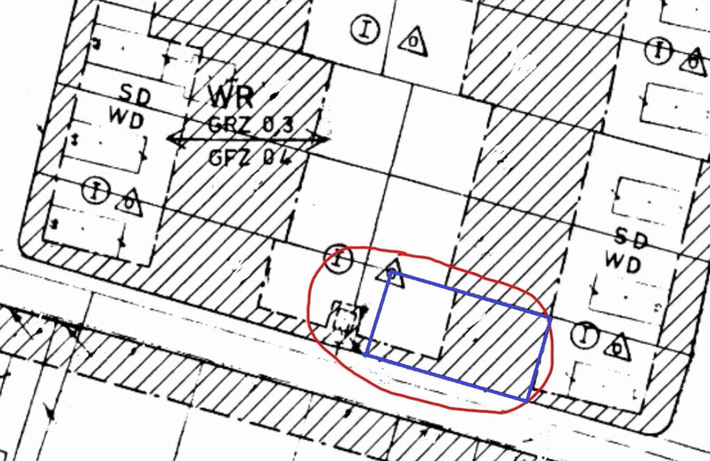

- The plot is about 17 x 29m (56 x 95 ft), the street is along the long side; the house must be positioned on the left side (see zoning plan excerpt, blue area is the plot, a small section on the left is separated and does not belong to us – no right of way)

The excerpt from the development plan looks very familiar to me – just save me the trouble of searching and give a hint under which username you were previously active ;-)
The small section of the development plan looks very familiar to me – save me the trouble of searching and just give a hint under which username you were previously active ;-)Yes, we both have an account here: @nanellaAlright then… here: https://www.hausbau-forum.de/threads/wie-bremer-2-3-loesung-mit-hohem-kniestock-erreichen.45696/ are further excerpts from the development plan (and I also want to ask: have you had a look at Ernst & Ernst in Achim yet?).
How do you explain the unusual shape of your building envelope compared to those of the neighbors?

Could you please show your plot as a rectangle with the house marked on it? I don’t understand the hatched area and the white rectangular spot. The legend is missing. Or is the white area the building envelope?
It would be helpful if you listed the zoning plan more clearly according to the questionnaire. Your explanation is full of negative assumptions. A more neutral description, without interpretation, would be better. Those interested can then form their own opinions.
(and I’d like to add: have you already visited Ernst & Ernst in Achim?) We have decided not to go for a solid masonry build, so I think Ernst & Ernst is out of the running. We have now found a general contractor (GC) we are quite happy with, as many of the problems we encountered with other providers simply don’t appear here.
How do you explain the unusual shape of your building plot, especially compared to those of the neighbors? I’m not exactly sure what you mean, but on the left edge of the original parcel there is a small electrical cabinet (no idea exactly what it is) belonging to the city (it doesn’t make any noise or anything), hence the small notch. Apart from that, the building plots in this area all look very similar: you’re allowed to build up to about the middle at most and then fixed to one side. Because the left part of the parcel was separated, we lost quite a bit of building width as a result.
