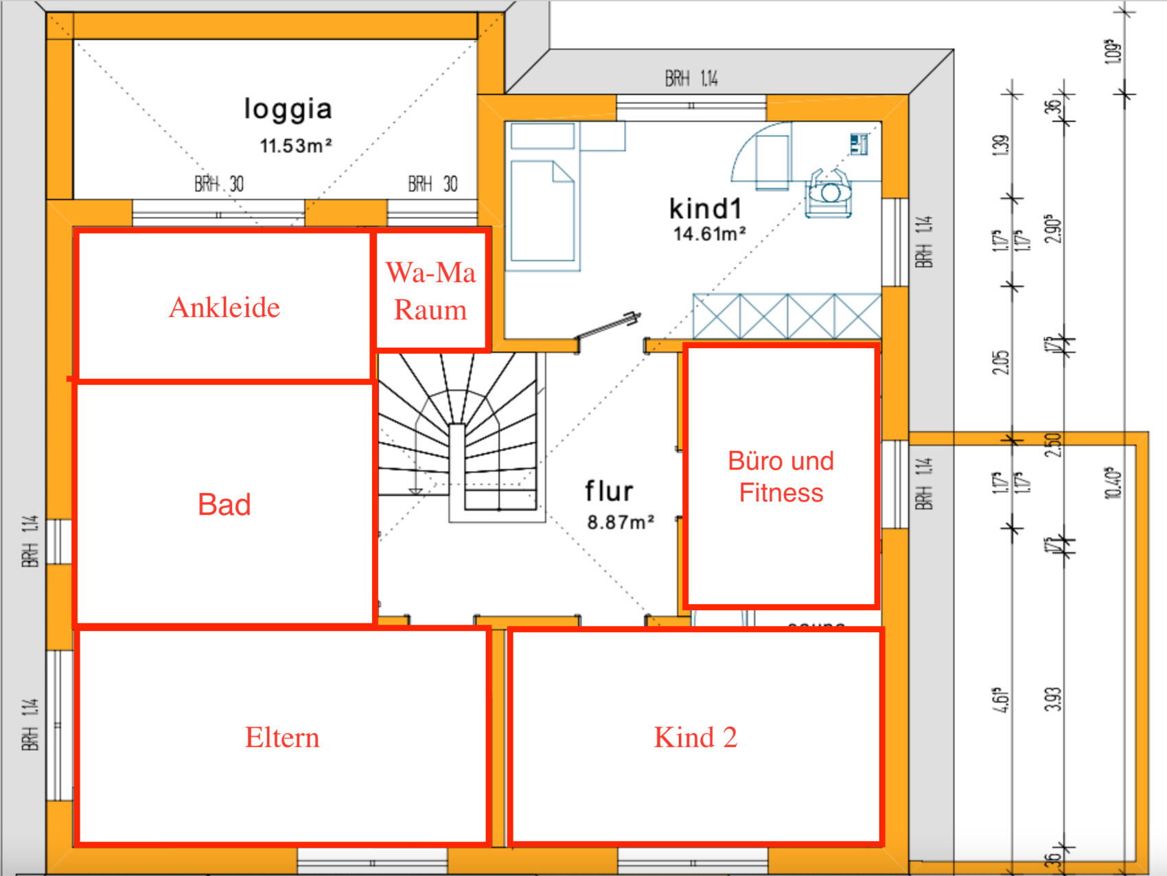

Schorsch_baut25 Apr 2024 12:44I have a practical question – doesn’t a hot tub also need a water supply and a drain connection? And the sauna and fitness area are located very far from the hot tub. To me, none of this makes sense.
Child 2 should be near the bathroom, the bathroom near the master bedroom, and the master bedroom near Child 2’s room, which I think would be more logical.

Schorsch_baut25 Apr 2024 14:05ypg schrieb:

I have a practical question – doesn’t a hot tub also need a water supply and a drain connection? And the sauna and fitness area are very far from the hot tub. None of this makes much sense to me.
Child 2’s bathroom, bathroom connected to the master bedroom, and master bedroom next to child 2 would make more sense in my opinion. That definitely should be planned in. I had it in mind; maybe the architect didn’t...
Schorsch_baut schrieb:
I would plan it like this – or have the fitness and utility room on the upper floor. Thank you for providing specific suggestions. I find that really helpful!
However, I don’t quite understand the drawing and the text, since you wrote “or fitness and utility room on the upper floor.” According to your drawing, both are already on the upper floor, aren’t they? Am I missing something?
You were only referring to the location and not the sizes in the plan, right? I’m asking because the utility room is currently only about 6–8 m² (65–86 sq ft). The office and fitness areas wouldn’t fit in there together.
