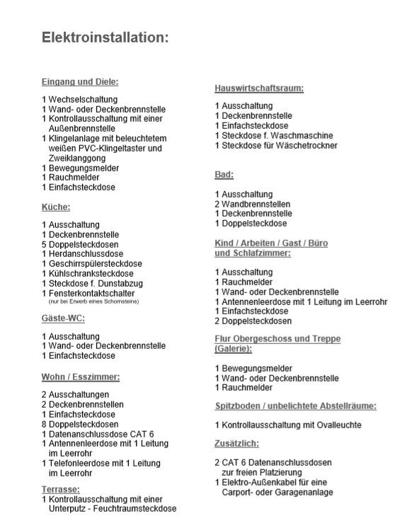

Does the company know about your plot and the current situation with the spread, uncompacted soil?Here is part 2:I don’t have time to read everything right now.
I would say it’s a good basis. It clearly states how much soil will be excavated and how much mineral aggregate will be filled.
This is for flat plots – additional costs will apply in your case.
The drainage ends as soon as it leaves the house.
Make a list of what is still missing and also note things like
extra charge for door panel (if desired)
bathtub too small
etc.
The electrical installation seems too basic to me. Think carefully about what you want and need. I have seen prices ranging from 25 to 60 euros for a single outlet.

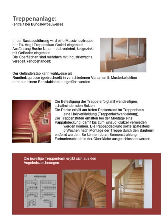

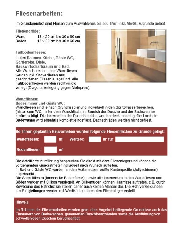

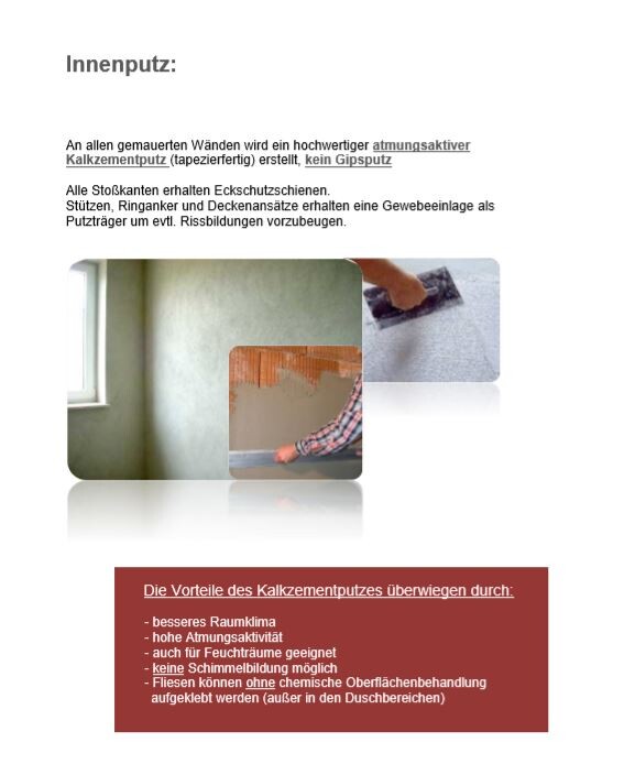

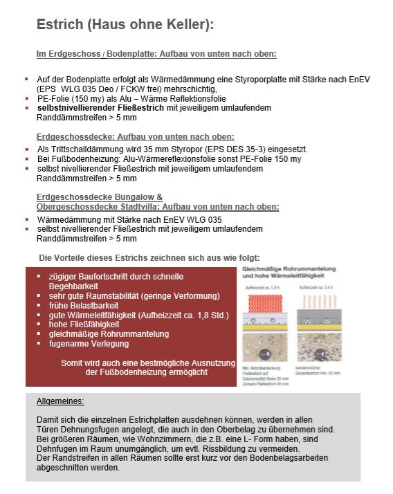

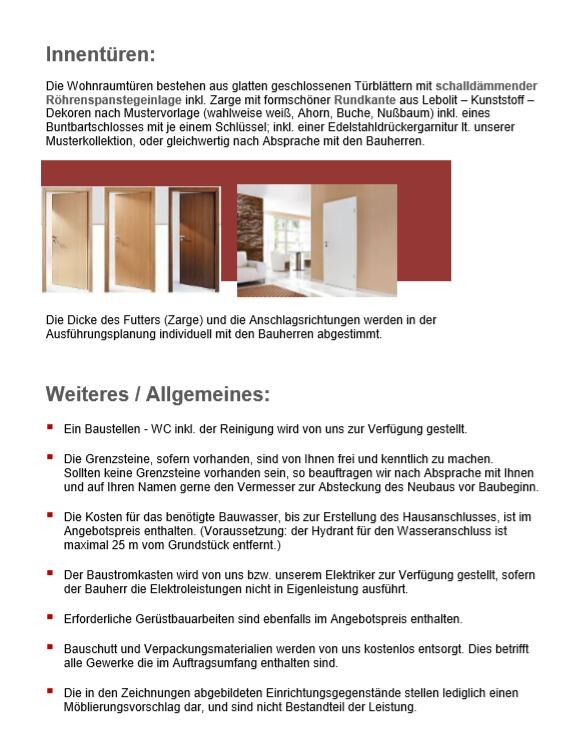

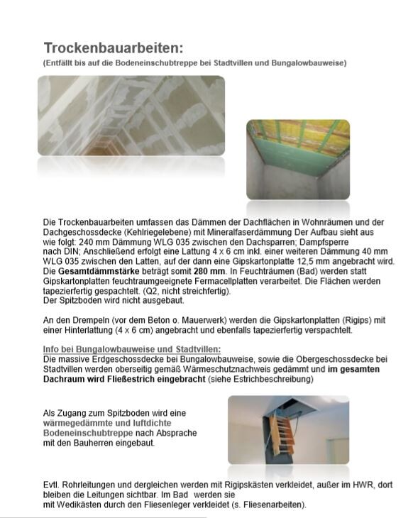

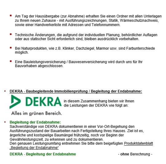

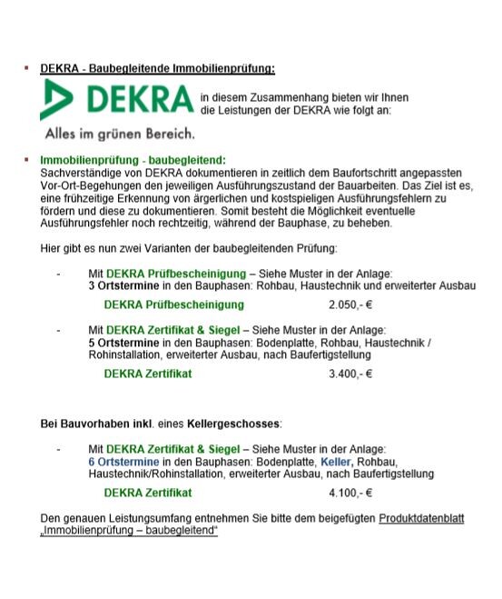

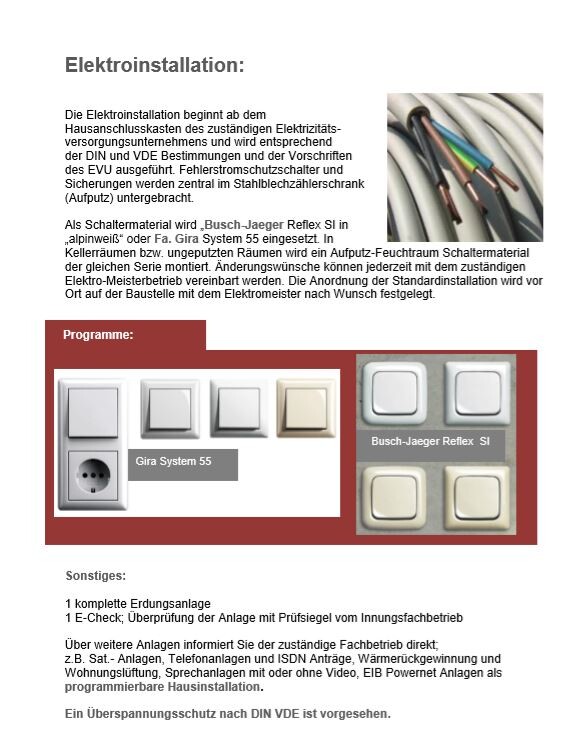

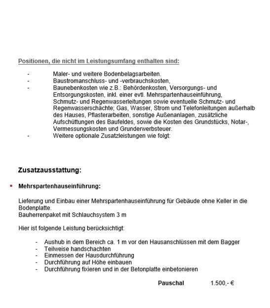

Franky73 schrieb:
Here is the construction scope description It’s a pity that the image format makes it difficult to quote from. I really liked the way the brick joints were filled using the bricks’ own mortar color.
This is a very neat and excellently designed description that goes well into detail. It’s definitely not a low-budget approach; you can read many indications of knowledge and experience, without any dodgy shortcuts.
Personally, nowadays I would always install additional empty conduits alongside every cable bundle (i.e., empty ducts for future upgrades), because in ten years you’ll get used to your refrigerator that reorders milk automatically much faster than you might imagine today.
