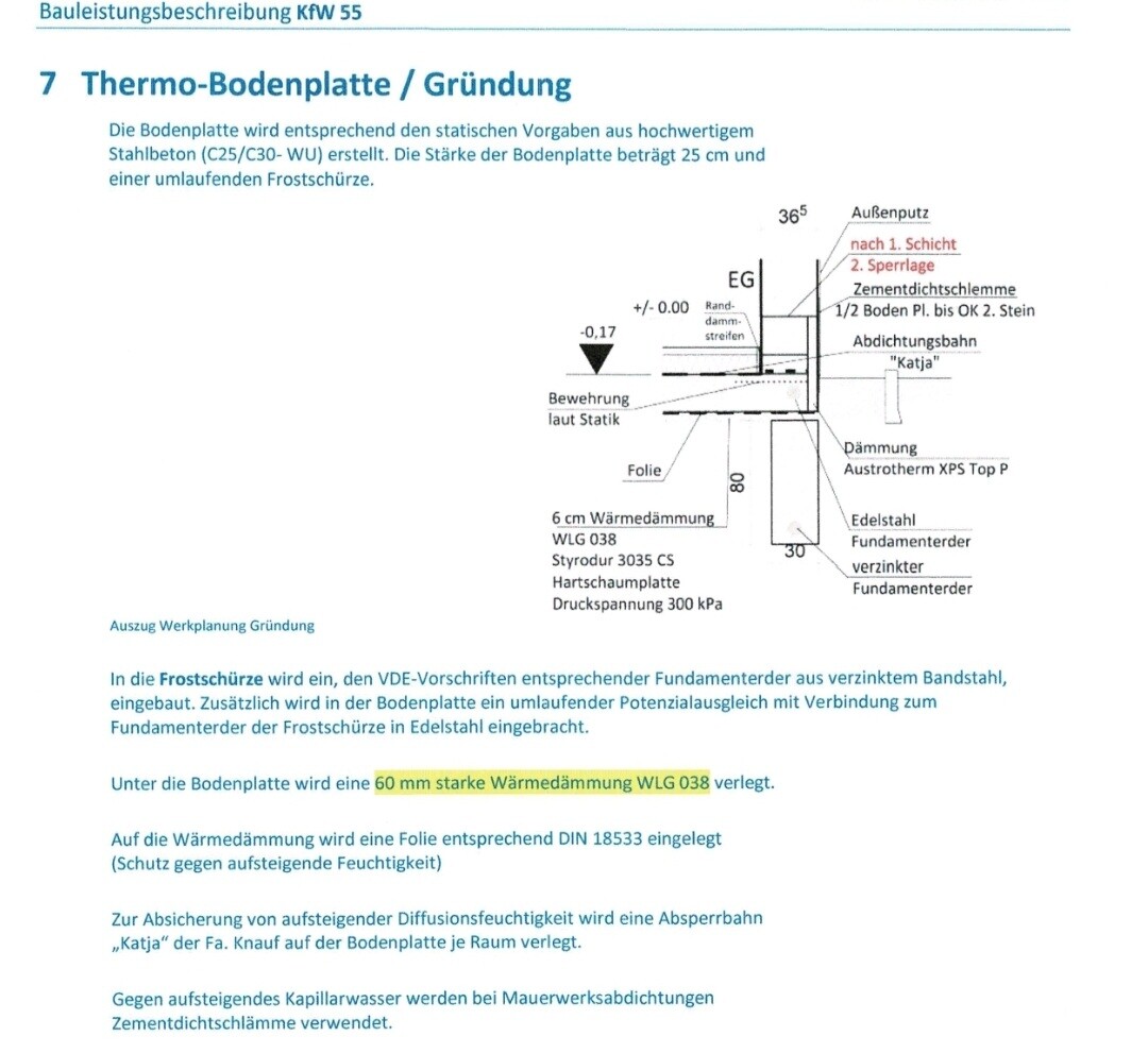

Neubau20228 Sep 2022 10:57We are hopefully nearing the end of construction. We are also building a 140 sqm (1,507 sq ft) bungalow in Brandenburg. A waterproof concrete slab is included in the price. The waterproof tanking is for the basement. The waterproof concrete slab is for the foundation. Here is our setup of the floor slab.

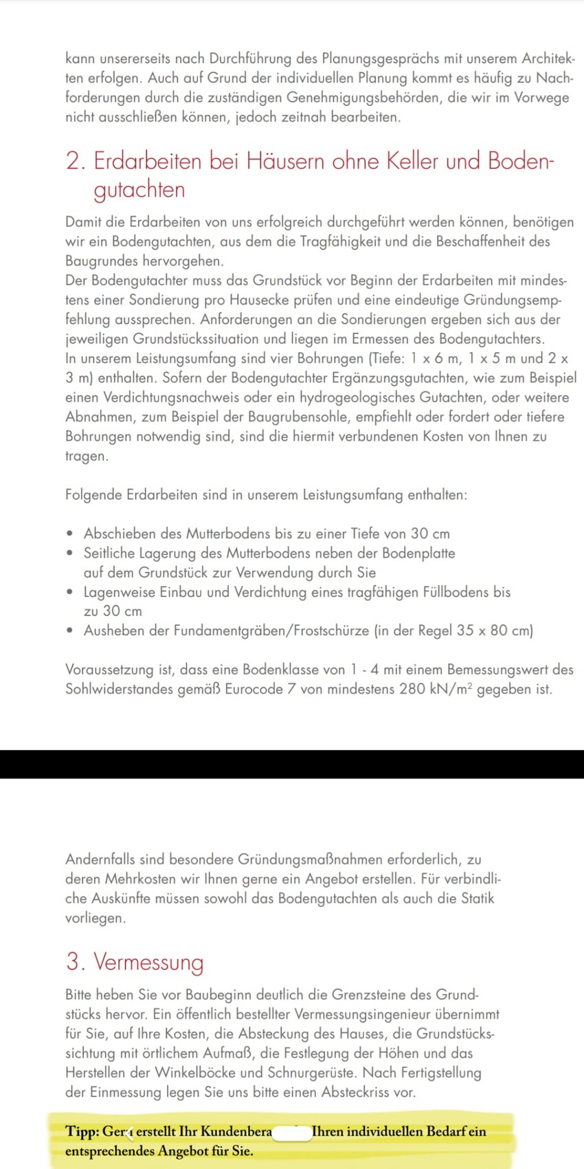

Osnabruecker8 Sep 2022 11:49EinmalimLeben schrieb:
We have the geotechnical report available. According to that, we need waterproof concrete.I don’t see any mention of waterproof concrete in the excerpt?
And there are no details about the slab in the brochure/contract either.
The only current difference is the strip footings being 80 cm (31.5 inches) wide instead of 90 cm (35.4 inches) as specified in the report.
Did I miss something?
