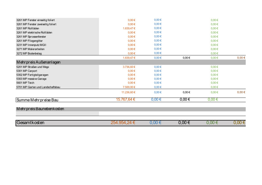

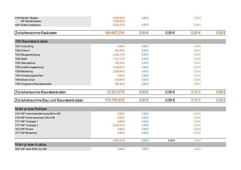

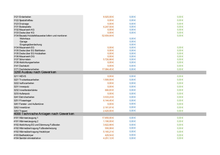

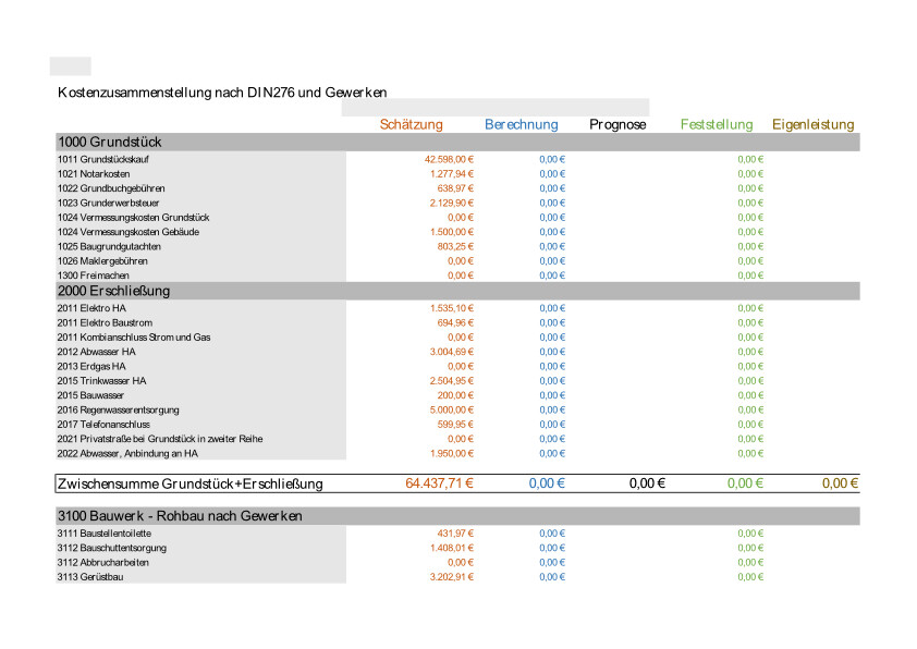

254k€ incl. or excl.? I already wrote that it includes the plot! I have the documents! I just don’t want to post them because your name can be seen there.
When am I supposed to laugh? At you for believing the price or at the engineer for being so stupid?
How much did your plot of land cost? Do you think that with the difference minus additional construction costs you can get a house? What would the price per square meter/dollar for the house be then? 900€
Franky73 schrieb:
I did write that it includes the land! I have the documentation! I just don’t want to post it because your name can be seen there.Sometimes you make a typo.
With such a huge amount, it’s reasonable to ask for clarification.
Take a photo of the offer and redact the name digitally. Then please upload it as a JPG.
With such an insane amount, it’s worth double-checking.
Take a photo of the quote and redact it digitally. Then please upload it as a JPG. Here’s proof so you can slowly start to believe it! The house was offered as a prefab house in timber panel construction:
If I didn’t know that you and he are serious about this, it would be both funny and sad at the same time. After seeing the numbers, I can only say that he would have sent you into personal bankruptcy without hesitation. You would have been short by at least €150,000–200,000 (about $160,000–215,000) for the house. That’s absolutely unacceptable on a personal level. It’s good that you registered here.
But since I’ve been talking endlessly and you’re still talking about hiring individual trades and an engineer, this is really getting annoying. Listen to the people here who have experience and cut off all contact with that engineer. Have a house built by a general contractor (GC).
