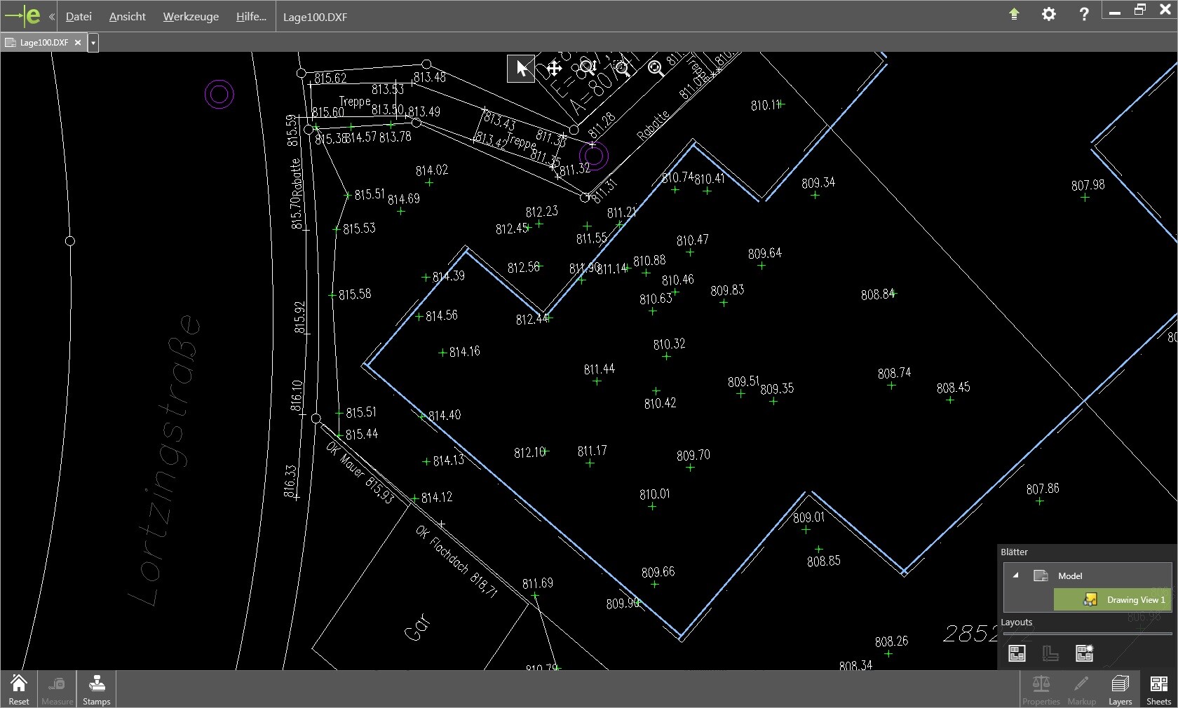

I would like to gather as many opinions and experiences as possible regarding my current floor plan. After all, building a house usually happens only once, so it needs to be right. What potential issues do you see in the design? Any kind of criticism or ideas are welcome.
The plot is quite complicated (see topography in the attachment):
The street/driveway is at 815.90 meters (2677 ft), the ground level ranges between approximately 809.xx and 810.xx meters (2654-2657 ft) --> about 6 meters (20 ft) height difference to the street and about 1 meter (3 ft) within the building site.
Therefore, the living floor is on the ground level, bedrooms, utility/technical room in the basement, and office/guest/cellar also in the basement. In the floor plan, guest and office rooms in the basement are swapped: the office is the larger room.

Here are the attachments 🙂
CAD site plan of a plot in DXF format with boundary lines and coordinates.
