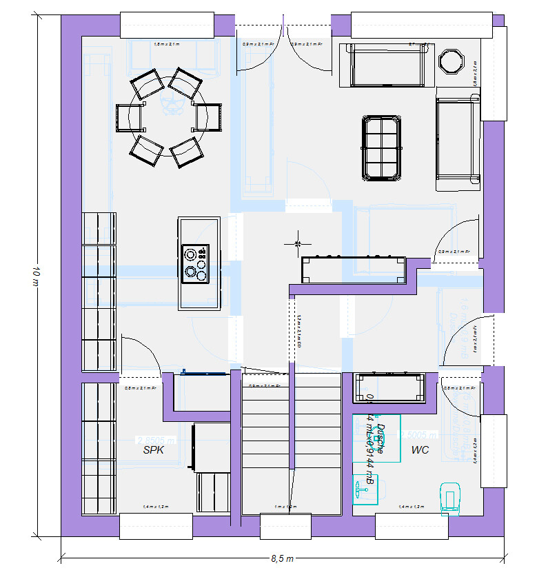

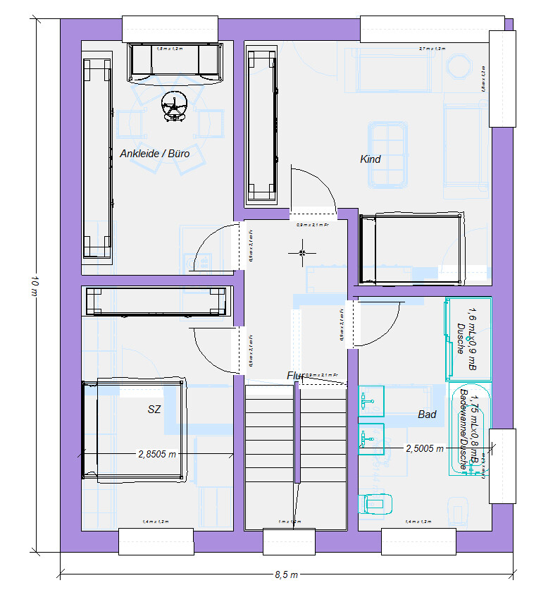

Stairs not located in the living area and entrance on the north side (right side of the plan):
Floor plan of a house: bedroom (BR), dressing room/office, child’s room, hallway, bathroom with shower
Floor plan of a residential house: kitchen with island, dining area, living room, hallway, stairwell, guest toilet
Off-topic: I’m wondering if, as the builder, I could now build 9.5 x 10 on one side and 7.5 x 10 on the other? The building authority shouldn’t really care as long as there are two residential units and the building plot isn’t exceeded, right? If that’s the case, you could give yourself a slightly larger share and squeeze the tenant into a standard layout with a 7.5-meter (25-foot) width.

I’m not really sure what exactly puts you off about the usual floor plans. Here’s an example with a landing. Try to describe what you want differently.
With a basement and expansion potential, you probably won’t get around the landing.
Well, I can’t really say exactly, it’s more of a gut feeling. I find it boring and uninspired because it feels like 90% of all semi-detached houses are designed that way. My gut also tells me that the standard is standard for a reason — because it makes sense and has been tried and tested — but that doesn’t mean you can’t look for an alternative that is equally practical. I’m not stubborn about it though. If a straight staircase wastes too much living space, it’s out, period.
But I would like a landing. I think that’s an acceptable compromise. Anything as long as I don’t have to walk on narrow, tapering steps.
What we definitely don’t want are open staircases in the living area. The thought of my daughter in 14 years bringing her awkward boyfriend past me on the couch in her pajamas... ugh, no. The basement stairs should be closed off anyway, as it won’t be a living basement, see below.
I would include the guest room/office in the basement instead. There’s plenty of space there.
Theoretically yes, but we’ll have to painfully squeeze the basement out of the budget. It’s unlikely to become a finished living basement...
kaho674 schrieb:
Staircase not in the living space and entrance on the north side (right side of the plan):
Cool! I didn’t get around to it last night but already had a vague idea to try something similar. Graph paper and pencil are ready, maybe I’ll manage it today. Unfortunately, I often have home office in the evenings once the child is finally asleep. I like the window at the "stairwell"! Having an entrance on the north or south side is important to us. Or one entrance on the north/south and one on the east/street side. That way there would be a certain separation.
