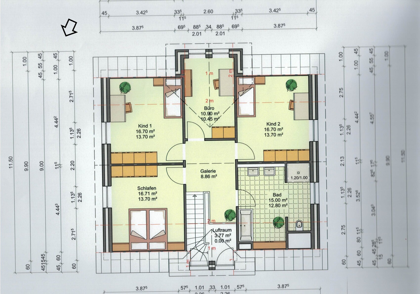

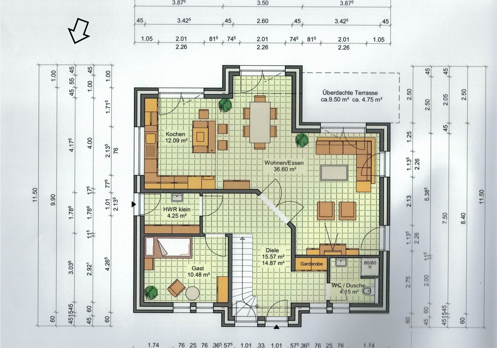

ᐅ A traditional single-family home of approximately 160 m² is looking for ideas and opinions.
Created on: 19 Aug 2018 12:30
HelixHello Forum,
first of all, thank you for this platform, from which I have already gathered many suggestions and ideas.
We finally have our plot and are currently deep in the floor plan design phase.
However, since most planners have only implemented our ideas without offering creative or challenging suggestions, we are unsure if we are on the right track.
Therefore, here is our current plan along with some questions.
Thank you very much for any input!

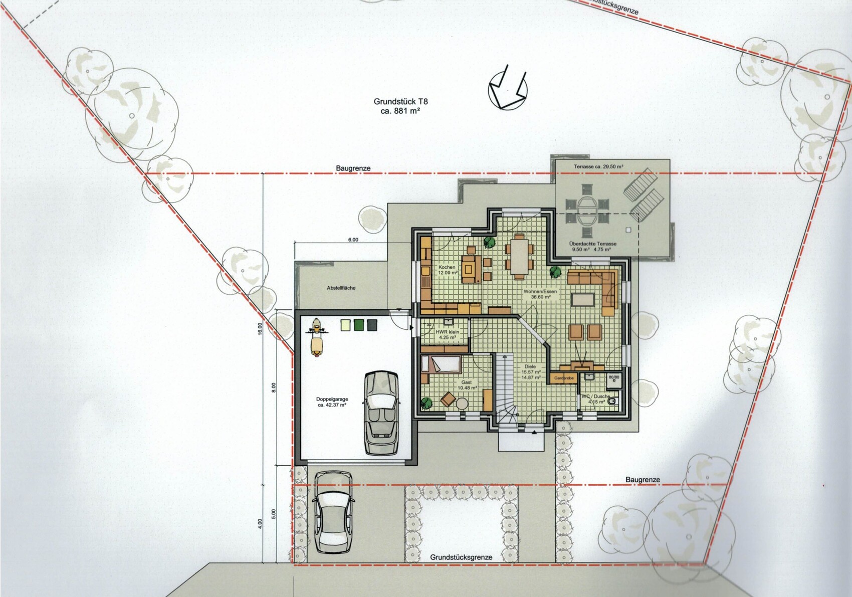

Building regulations/restrictions
Plot size: 970 m² (approx. 10,440 sq ft)
Slope: slight incline to the south, about 1–2 m (3–6.5 ft) across the entire plot
Floor area ratio / plot ratio: 0.4 / 0.8
Building envelope, building line and boundary: see drawing

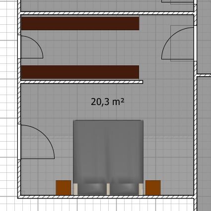

- We are not yet happy with the sofa corner with TV options; corner sofa in the room or in front of the window feels awkward.

A sofa that is visible from the entrance does not create a cozy atmosphere.
You have a bit of a catch-22 situation with the sloped ceiling, especially with the double door included.
If the hinged door also has windows, no one is likely to feel comfortable in the living room.
Since the window placement and terrace accessibility are somewhat problematic, I would ask myself whether this really is the house for you.
I generally miss the slope of the site.
At first reading, I imagined a walk-out basement, also serving as an entry level. More of a single-pitch roof with a larger open space. Only the four gables made me hesitate and brought me back to reality.
Was there a site plan included above? Perhaps you could also draw a side view plan to show the elevations...

About the upper floor: you now have 2 offices/guest rooms... and a basement. Okaaaay
My basic opinion is: if a 3-meter (10-foot) closet doesn’t fit in a bedroom for the parents without a walk-in wardrobe, then there is something off with the layout. The bathroom isn’t great either.
I would swap the bathroom with the bedroom so that the missing 3m (10 feet) closet from Yvonne's critique can fit behind the door. Also, switch the kitchen with the living room, and you'll have your cozy corner.

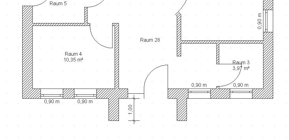

I think the idea of adding another bay window is nonsense.
Otherwise, I don't see any serious mistakes or brilliant improvements in the design that would get more out of the plan. If you find it too boring, the only option is to start completely over. If it works for you, then build.

@ypg: The slope across the entire plot is about 1.5 m (5 feet) in height difference, so on the buildable part maybe around 50 cm (20 inches). I don’t think starting with a basement or similar makes much sense here. We simply don’t like shed roofs, but it would certainly be a good option. I completely agree with you about the bathroom! We’ve already noticed that and it still needs to be changed.
For the bedroom, we considered adding a partition wall to create a dressing area with plenty of closet space and a vertical strip window, but I’m not sure if it will feel too cramped (see attached image)?!
@katja: Thanks! The idea of swapping is too simple to have come up with myself. I’ll suggest it to my better half.
Regarding the bay window: Is a roof really necessary to prevent guests from standing in the rain?
