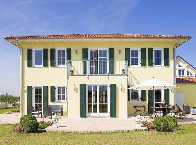

My main issue is when customers buy a house based on a catalog photo like this one:
Bright two-family house with green shutters, balcony, terrace, and people outside.
which obviously is over 170m² (1830 sq ft) and only works because of its size. Later, they wonder why their own 140m² (1507 sq ft) house doesn't look as nice or why the floor plan turns into a disaster. For me, whether the catalog house has a symmetrical or asymmetrical design is not really important.

I mainly think that the house with the shutters only looks good because the roof overhang is so large. This is probably not standard and would likely have to be paid for as an extra.

I mainly think the house with the shutters only works because the roof overhang is so large. ...
The shutters are practically dismissed now. I was convinced by the discussions here in the forum.

Oh... one of my dream houses has red brick, a red roof, white windows, and shutters—in theory.
In practice, only if you can automate them to open and close; otherwise, sliding shutters work better because that’s possible.
I like the way they cast shadows.
That said, I have to admit that I’ve really come to appreciate our external blinds (also known as shutters or louvers) on the south side because you can almost continuously adjust the tilt angle. When I move around the room, I need a different setting than when I’m sitting at the computer. You can’t do that with shutters.
