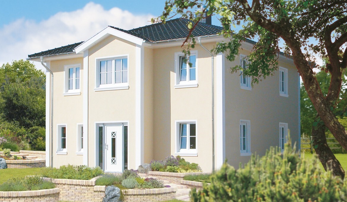

I kindly ask you to review the floor plan of our future house and thank you in advance for your time and attention. The floor plan has not yet been reviewed by an architect.
--> Despite many efforts, I was unable to make the drawings larger. They originate from Sweet Home, were converted into a PDF, and then into a JPEG. If there is a better way to do this, please let me know. Otherwise, I hope it won't be too much trouble for you to enlarge the floor plans on your computer. It is possible, but as mentioned, I could not upload them in a larger size on this site. :-(

There has been no architect consultation yet. The floor plan is a mix of example floor plans from various prefab home providers and our own ideas and requirements. Two special features for a relatively small house are, in our view, the somewhat larger utility room (which should be nearly like a second kitchen for hobbies) and the sauna in the master bathroom, which required a larger bathroom than we would need without the sauna.

It is a "promotional house" that we have modified slightly. Oh dear, you really don’t want to know what nightmares that phrase gives me.
Pinkiponk schrieb:
The house can also be cost-neutral if rectangular, but we'd prefer it square. Secondly: see the symmetry aspect; and first: that would render the basis of the "promotional house" absurd, if you ask me.

Oh dear, you really don’t want to know what nightmares I had after those words.I know people who find nightmares exciting because they’re thrilling. I agree with you that there isn’t much left of that “pre-configured house.” Essentially, everything except the square shape is different, so I shouldn’t really call it that anymore. It’s not stated anywhere in the offer or the contract.11ant schrieb:

A rough idea (red roof, no bay window, only French doors on the ground floor, and somewhat larger windows upstairs) is shown in the attached photo. Probably boring, but I like it.
