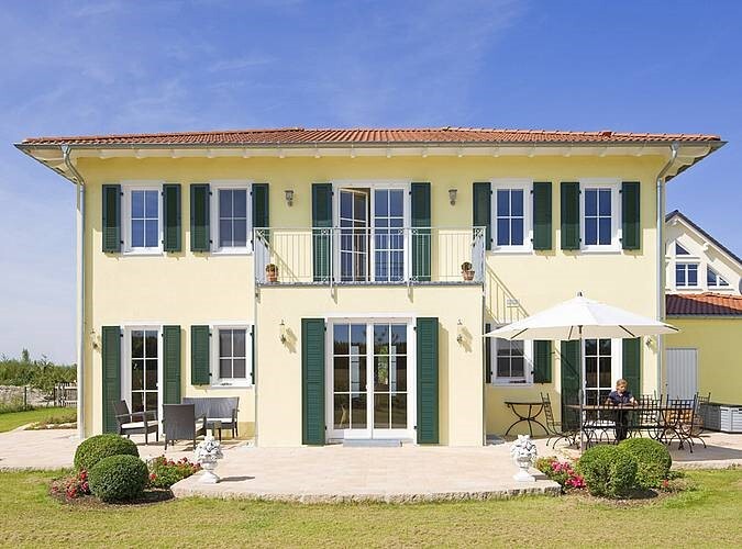

Pinkiponk6 Jan 2020 18:40Nordlys schrieb:

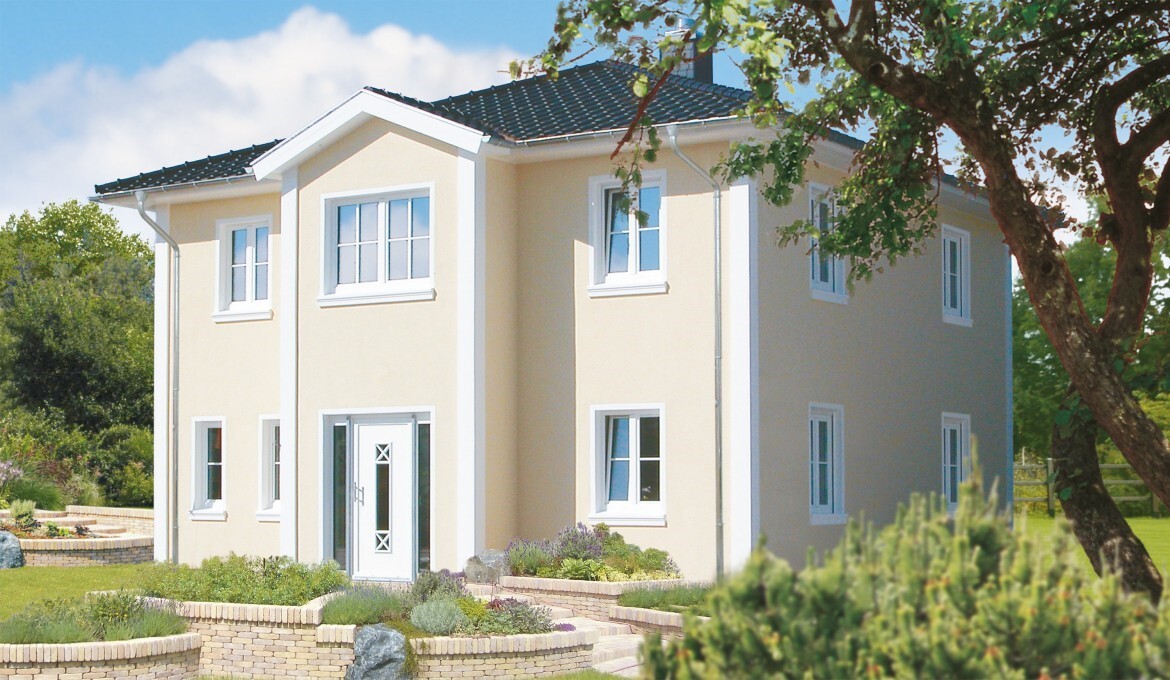

I really like the house in the picture. Please don’t spoil it with shutters like the ones common in Bavaria.Here is another house picture with shutters. But I think you’re right, in my opinion, shutters add more visual disturbance to the facade. If I can convince my husband, we’ll build without shutters, which will also save us quite a bit of money. Although, the house shown earlier with white shutters could also look pretty good.Similar topics
