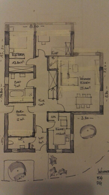

Hello
Attached is our floor plan for a bungalow with a pitched roof (storage space under the pitched roof).
The kitchen and bathroom fittings are yet to be planned. Only the room sizes are defined. Doors can still be moved slightly.
At the staircase area, a small entrance hall can optionally be installed (less heating required). The terrace will be semicircular at the front, so slightly larger.
The main focus should be on interior optimization.
The maximum width of the floor plan is fully used – unfortunately. One meter (about 3 feet) more would have been better.
What else could be improved?
I have attached the plan as a PDF and JPG.
Thanks

Who planned it:
- Architect + do-it-yourself
What do you like especially? Why? – Quiet area on the right side. Living room facing south
What do you dislike? Why? – Master bedroom suboptimal
Price estimate according to architect/planner: 300,000
Personal price limit for the house, including fixtures and fittings: 300,000
Preferred heating technology: To be developed with building services engineer – energy planner
If you had to give up, which details/extensions
- Could you live without: /
- Could you not live without: /
Why did the design turn out this way, for example:
Standard plan from the architect? – No, our wishes were taken into account
Quiet area partly copied from a prefab house provider
Master bedroom with continuous wardrobe wall – passage from bed to wardrobe too narrow (only about 50 cm (20 inches)) ...

Sorry, I’m not really happy with this design. A lot of space is lost to long, dark corridors. You enter the door and it immediately feels cramped. Having two doors so close together is annoying. The kitchen also seems small and cramped, even though the area should actually be sufficient. The bedroom is 17m2 (182.9 sq ft), yet you can only fit a 1.50m (5 feet) wardrobe? That wouldn’t even hold half of my clothes. My husband would still have to walk around naked. The distance between the TV and the sofa seems too large. Overall, there is far too little space for wardrobes or storage.
Grrr.... I think the terrace options offer more potential hereAh yes, see also https://www.hausbau-forum.de/threads/130-m-bungalow-mit-doppelcarport-bei-600m-Grundstück.26171/page-10 #59 – the plot looked familiar to me right away – @Elnino: why start a new thread at all (and without referring to the original)?https://www.instagram.com/11antgmxde/
