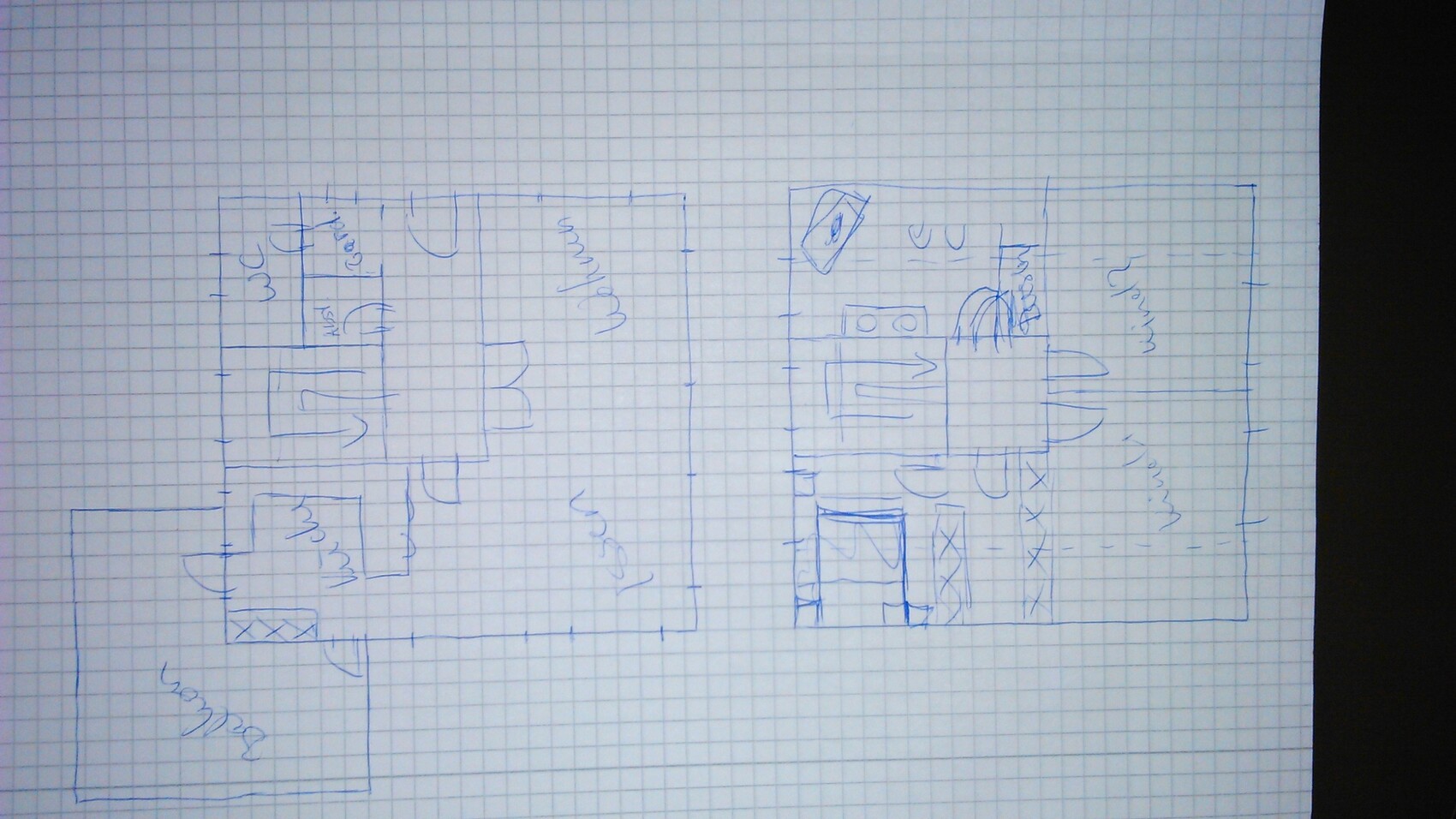

I don’t have my software with me right now, but I had an idea… Take a look if you can make out the sketch. :o
I would rotate the house on the ground floor by 90 degrees, as I mentioned before, and rotate the roof as well. Upstairs, I’d use the small gable for the walk-in closet to have a window there and enough space for large wardrobes…
That’s my idea.
That’s my idea.
Watcher7812 Sep 2015 15:28I just saw your drawing. Thanks for your idea and effort 😉 Is your drawing oriented with north at the top? We have the problem that we can only place our garage on the right side of the house, and unfortunately, the orientation you planned doesn’t work with that. You wouldn’t be able to have large windows on that side because the garage would be in front. Placing the garage on the left side of the house is only possible if we keep a 3m (10 feet) distance from the neighbor, which would waste valuable space. Aside from the room layout, our first idea was also to orient the rooms towards the east and south.
If we rotate the roof, the gable would face the garden. That would be better in terms of window placement, but a balcony on the gable side looks somewhat odd, so we decided to rotate the house perpendicular to the street.
Watcher7812 Sep 2015 15:44mh on the iPad the drawing looks different 🙂 is the entrance on your side to the right of the house where the garage is now?
