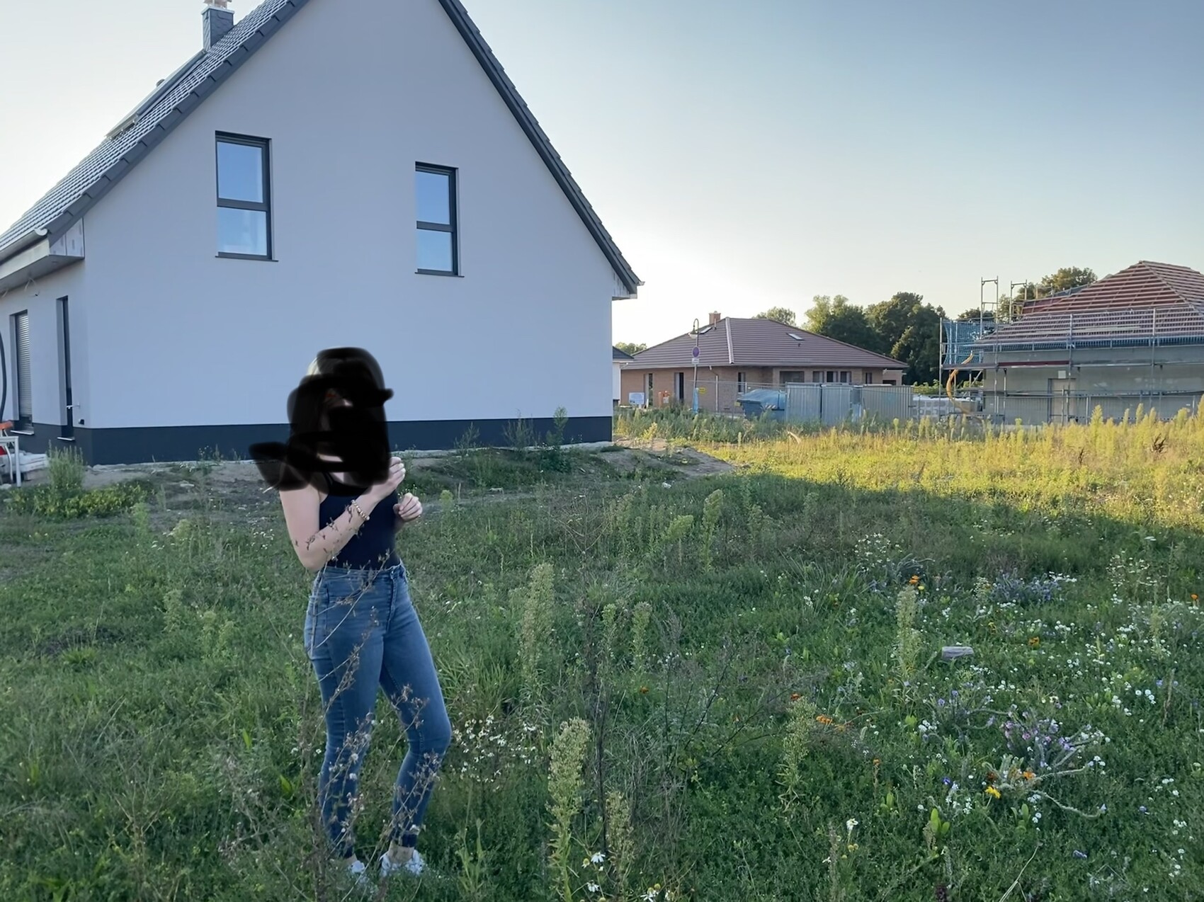

In which month was that? Do you have a photo?

We once stood on our property in the afternoon and thought about where the terrace should go. But because of our neighbor to the west, everything was in shade. Does that make sense?

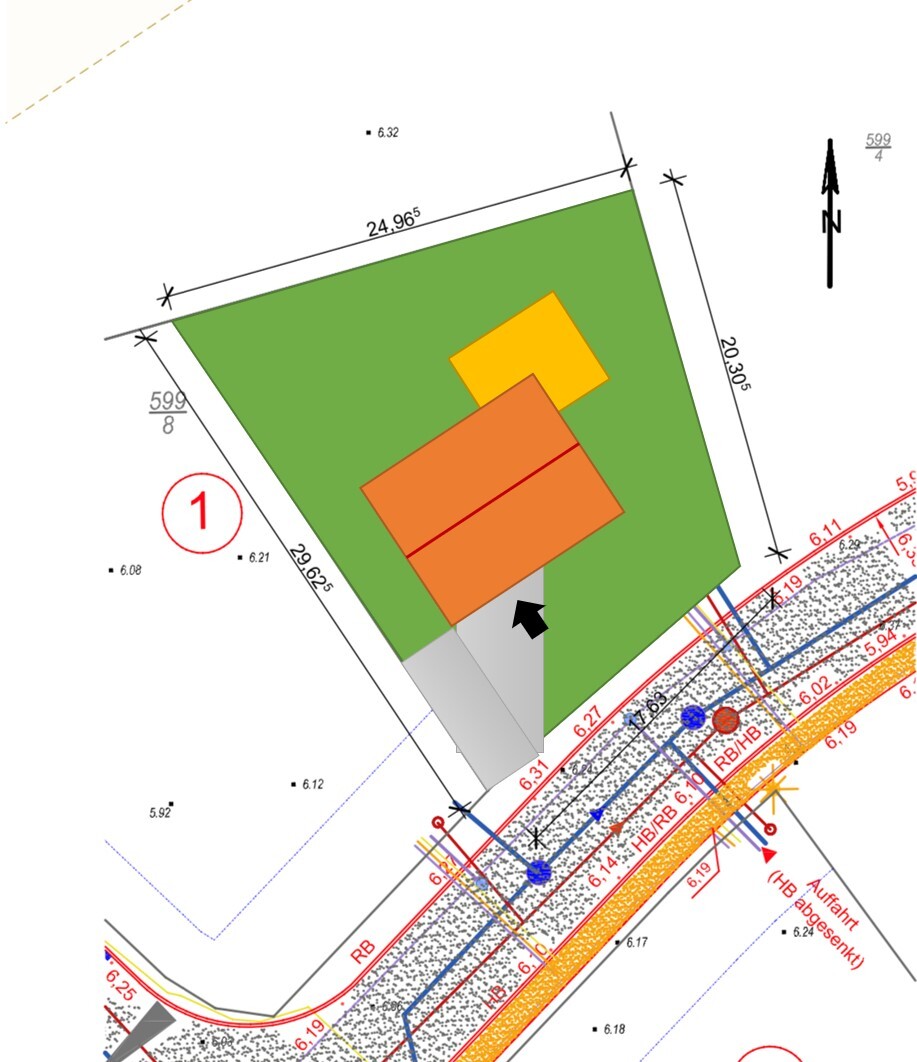

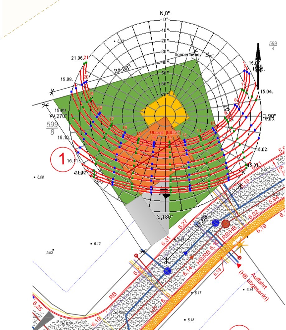

2) It’s not about having a west-facing neighbor, but that because of their 200m² (2,150 sq ft) cabin, half of our property is in shadow from 6 p.m. onward. WHY should I orient the house like that to theoretically catch the sun, only for it not to arrive due to the neighbor’s house? I already described and illustrated this.

[ATTACH alt="floor plan after first planning meeting 140m2 1.5 floors 549365-1.jpg"]68633[/ATTACH] [ATTACH alt="floor plan after first planning meeting 140m2 1.5 floors 549365-2.jpg"]68634[/ATTACH]
Advantages:
- Full sun on the terrace from 12 pm until sunset. If you build a corner terrace, you get sun from 7:30 am until sunset.
- Entrance on the long side avoids long corridors and allows for a nicer room layout (this is also the basis for many well-tested standard floor plans).
P.S.: Our house has the terrace on the south-southeast side, rotated about 10° from south towards east. Since there is no sun on the terrace after 6 pm, we built a second one on the north side. But “moving out” is always a hassle!For example, this photo was taken on September 1st at 6:45 pm. At that time, the part of the property where the terrace would be located is completely shaded. That’s why we had avoided it so far.
Does that make sense to you?

Does this make sense to you?At least these are arguments showing that you have thought about the location on the plot. And the arguments are understandable at first glance.
However, keep in mind that your house will also cast a shadow, which will shade the planned terrace from 3 p.m. onwards. From 3 p.m., there would be nice sunshine on the northwest side of the house—in the utility room and shower bathroom.
If you want to enjoy sunny living spaces, it might be worth considering a second terrace here that is also easily accessible, possibly via a dining area. If I have time later, I will try to make a sketch. I still maintain that for a house of this size, having the entrance on the long side offers many advantages and prevents unnecessarily long hallways and wasted square meters.

Maybe like this...
The terrace would receive sun on two-thirds of its area until 12 p.m. and on two-thirds of its area again from 3 p.m. onwards. Mainly, the house itself is shaded by the neighbor’s property.
In terms of room layout, the kitchen and dining area are located near the terrace. The utility room and shower bathroom face towards the neighbor.
It might also work with the house rotated by 90°. This would have the advantage that the gable windows on the southwest side would not directly face the neighbor’s wall.
