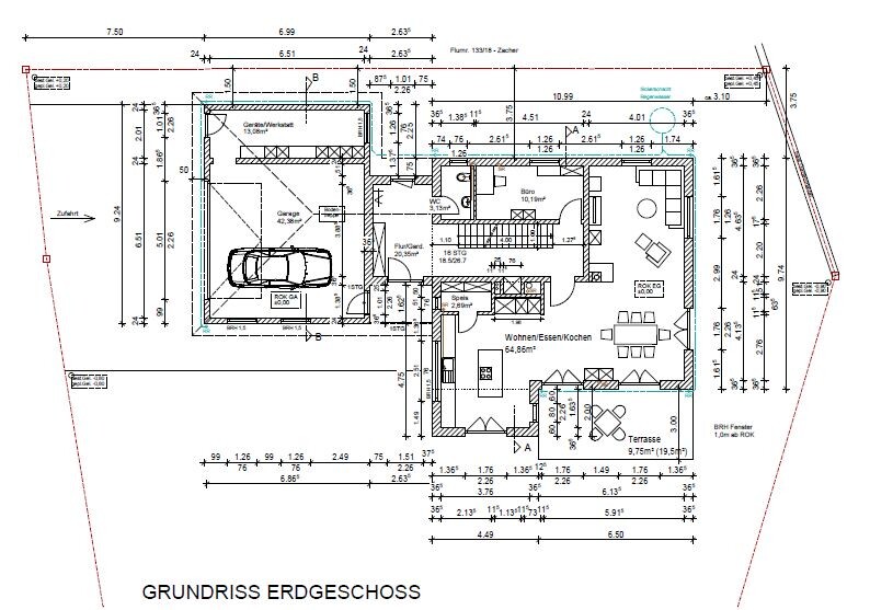

The floor plan is basically fixed, but for noise (street) and privacy reasons, we want to mirror the whole house so the garage, front door, bay window, house, and terrace are positioned from west to east.
Unfortunately, this has sparked many discussions because the plot was gifted to us by family whose house behind is slightly elevated (about 3m (10 ft), on the north side). They fear their house will no longer be visible from the south if we move the garage to within 2–3m (6.5–10 ft) of the western boundary. However, if we move it back 6–7m (20–23 ft) to where the current house corner is, there is about 80m² (860 sq ft) of "wasted space" between the boundary, street, driveway, and garage. Do you have any ideas on how to make use of this space or avoid it altogether without compromising the rest of the design?
The images still show the old version, as we will only redesign once we find a solution...
Thank you very much!

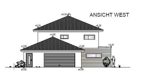

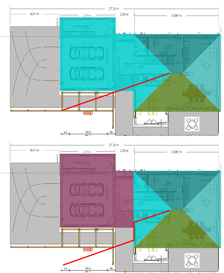

Grantlhaua schrieb:
I don’t understand why you can’t just build two hip roofs like before, The garage/entrance section now forms an L-shape.
Grantlhaua schrieb:
Sorry, I didn’t get that? No problem, I’ll draw it again, this time including the roofline from the side: in the top illustration, this side of the roof runs straight through, so—as shown in the lower drawing—I added a step that still allows for windows with a standard sill height on the upper floor on this side as well.
Grantlhaua6 Sep 2018 17:3711ant schrieb:
The garage/entrance section now forms an L-shape.He managed to design the roof as in the first draft. Thanks anyway.
That’s nice. I’m curious to see the roof inspection in this context. Did you understand my suggestion by now?
Grantlhaua10 Sep 2018 09:1811ant schrieb:
That's nice. I'm curious about the roof supervision in this context. Did you understand my suggestion now?Yes, I understood. I'll be happy to post a screenshot of the plan for you again in the next few days.
Basically, the ridge shifts slightly to the north and the overall roof height increases a little.
Grantlhaua13 Sep 2018 09:00Good morning,
unfortunately, I haven’t had the chance to upload the new plan via laptop yet, and it always appears too small on my phone...
What I can say for now is that mirroring the house was the right decision. The architect came this week and leveled the heights. We also staked out the house on the plot. We were very pleasantly surprised because now we can enjoy at least 2 more hours of sunlight on the terrace, as this is the spot on the property that gets by far the most sun. There is a large tree on the neighbor’s side to the west, which casts a shadow on the terrace’s original location.
