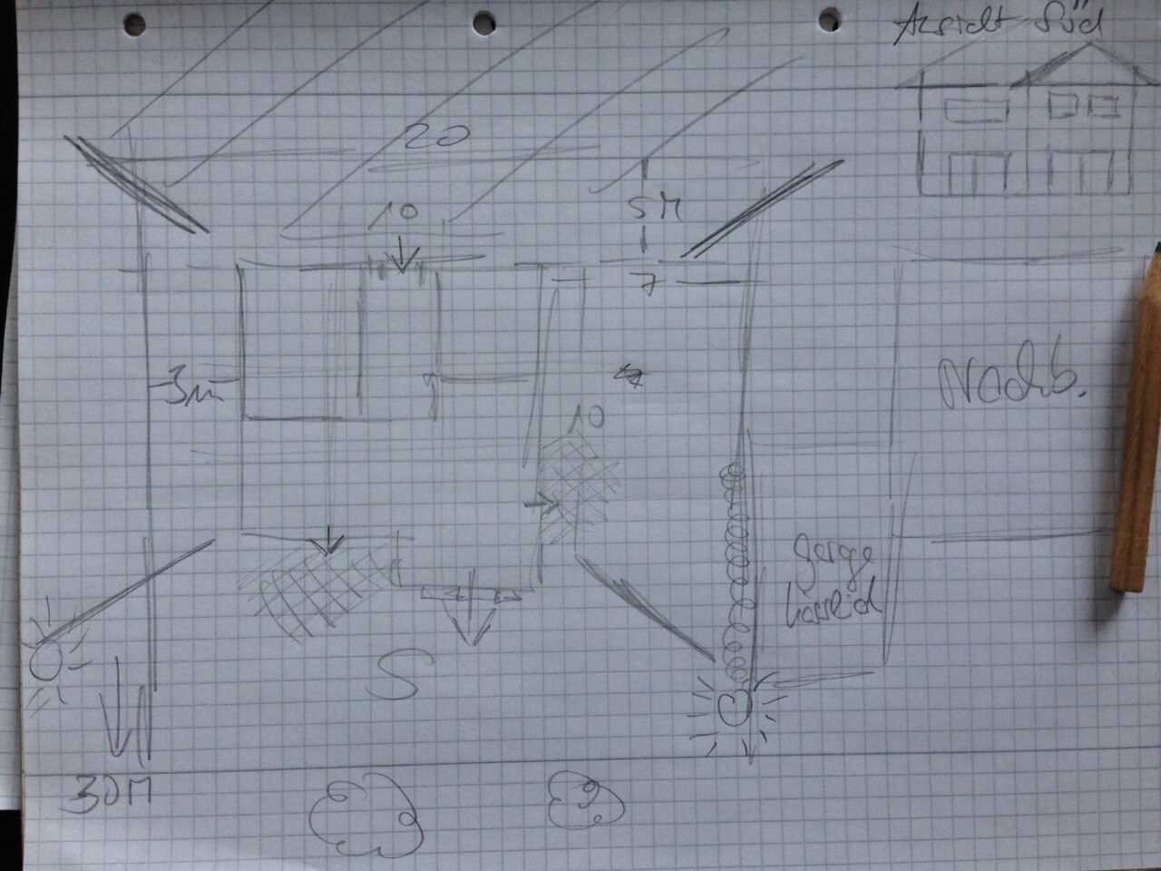

Regarding the sketch: We have a corner plot with roads to the north and east, and the floor plans are basically designed to position the house towards the corner (perhaps leaving about 4m (13 feet) of space to the north and east). The street is a low-traffic residential zone, so there is basically no traffic. Depending on the positioning of the house, it will probably be slightly above street level since the plot slopes gently in both directions (from west to east, I estimate about 5–7 percent, while from south to north it is more of a slight measurable incline rather than visible). The lowest point of the plot is the corner.
