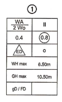

Plot size: 502 sqm (5400 sqft)
Slope: Yes, sloped. Approx. 3 m (10 ft) height difference from southwest to north
Floor area ratio (FAR): 0.4
Plot ratio: 0.8

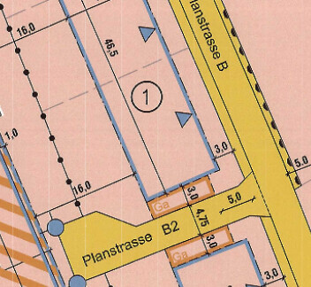

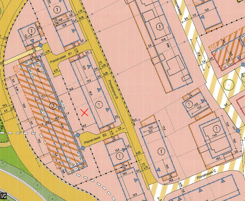

Building window, building line, and boundary: See excerpt from development plan (map oriented north)
Number of parking spaces: 1.5 per residential unit
Maximum possible residential units: 2
Number of floors: 2 full floors allowed, attic floor not allowed
Roof style: pitched roof and flat roof allowed
Orientation: no specifications
Maximum heights/limits: Residential building height max. 6.5 m (21 ft) and max. 10.5 m (35 ft) total building height measured from top of access road in the northeast
Further requirements: Garages/carports only allowed within the building window or the designated yellow-marked areas

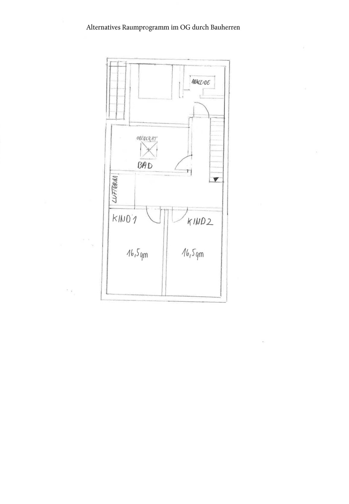

Who designed it: Concept from the architect and alternative versions of the room program from us.
What do you like most? Why? Split-level and open void space that reflect the idea of building with the terrain and having two terraces protected by pergolas with access to upper and lower levels. We also like that it is possible to walk all around the house. The open void keeps it airy and creates a continuous sightline upwards that could be closed with a skylight, for example. The volume was deliberately placed on the western edge of the building window, even though this brings it closer to the row housing, to enable a more sheltered terrace to the east. Because to the east, there are only garden plots and a narrow access road that is not intended as a main access.
What do you dislike? Why? Room layout: basically too small and difficult-to-use room arrangement. We are reluctant to give up the split-level because it carries the idea of working with the terrain and provides access to the lower and upper areas. On the other hand, it consumes space and functionality. The same applies to a potential open void above. Also, overall, the rooms are too small, especially given that there should be quite a bit of space available with 170 sqm (1830 sqft) of living area.

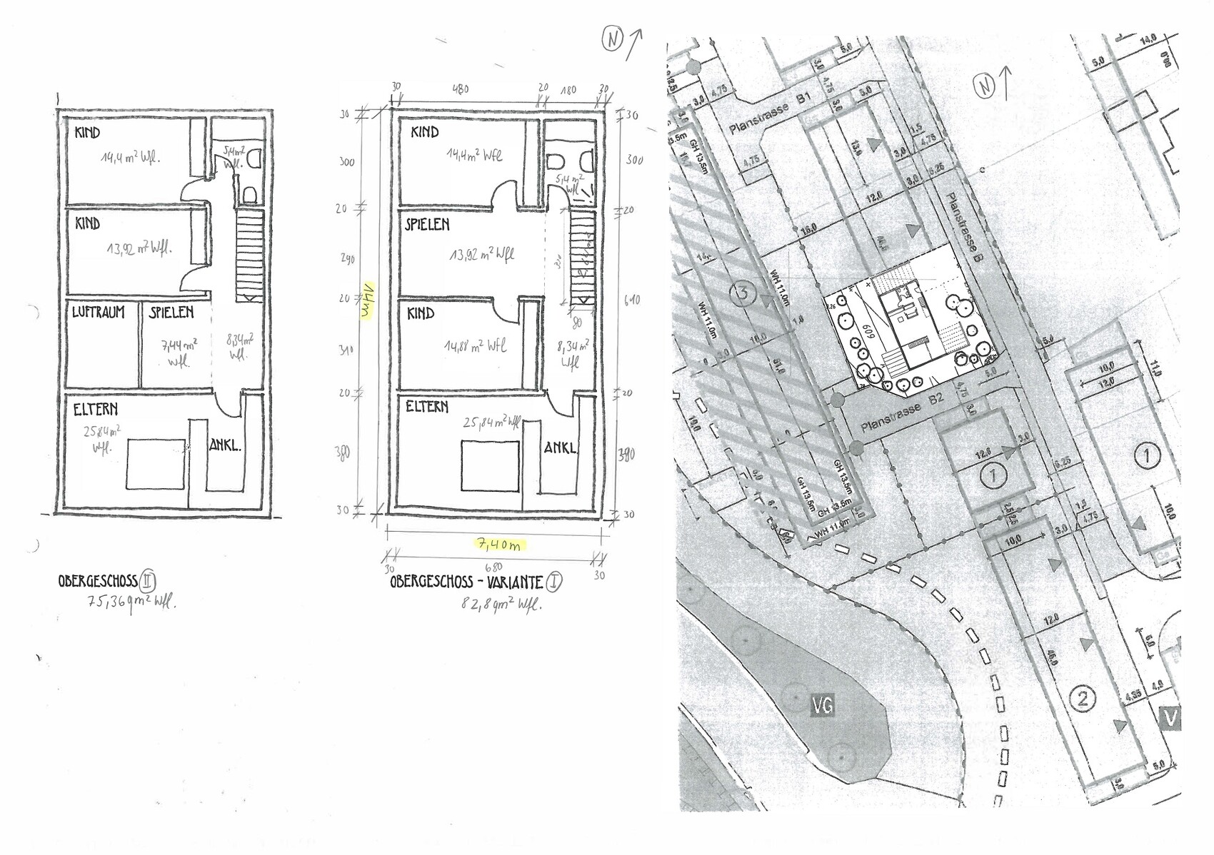

[IMG alt="OG.jpg"]https://www.hausbau-forum.de/data/attachments/34/34245-1dba1bcffe9276a24d7771734e7f8356.jpg[/IMG]
[IMG alt="EG_KG.jpg"]https://www.hausbau-forum.de/data/attachments/34/34246-c4723bc5436c3067eb0d370cb371b16a.jpg[/IMG]

We already included the basement garden last year with @SupaCriz. I definitely don’t see a split level here—as long as there is no half-story offset following the terrain—but rather just a multi-story living room. I also see a waste of space caused by two straight one-flight staircases, as well as a narrow townhouse positioned crosswise on the plot.
DASI90 schrieb:That’s hard for me to believe.
Architect’s design
I already knew it would be tough from the other threads. But somehow, I would have wished for a different first post about it.
Yes, it’s not really a true split-level. We just called it that for now. I agree with you that, like with two straight staircases, it takes up a lot of space. That was also one of the things we weren’t entirely happy with, even though we wanted to stick to the basic concept.
What I don’t quite understand is the orientation of the building mass? What bothers you about it, or how would you prefer to do it differently?
ivenh0 schrieb:
Two quick points:
- The kitchen is ridiculously small in comparison. 2.80m (9 feet) wide and a kitchen island doesn’t fit. It should be more like 4–5m (13–16 feet).
- The terrace should be next to the kitchen, not the living room. We definitely agree with point 1 and may even have a potential solution. Regarding point 2, I also agree, but currently, we’re not sure how we would implement it.
Garden level, then it gets a small pseudo-living space
Kitchen and dining area in the garden level
Stairs stacked on top of each other
Remove the void space on the upper floor, place a proper bathroom upstairs
Possibly a proper split level
There is too much focus on design and too little on functionality here.
Mini kitchen
Mini bathroom – reminds me of the bathroom in my first 45 m² (484 sq ft) apartment
Mini kitchen
