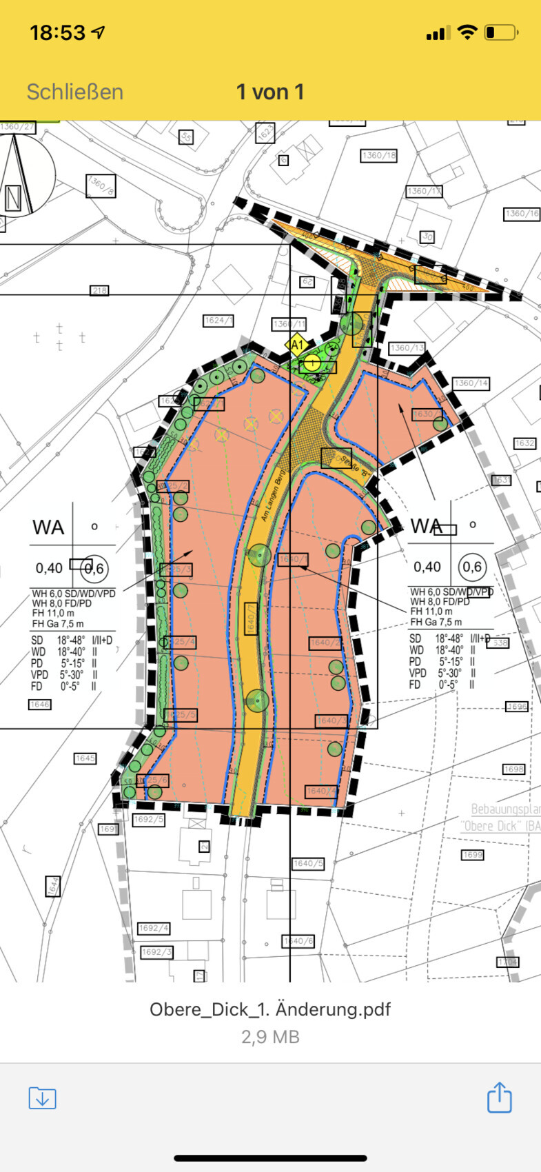

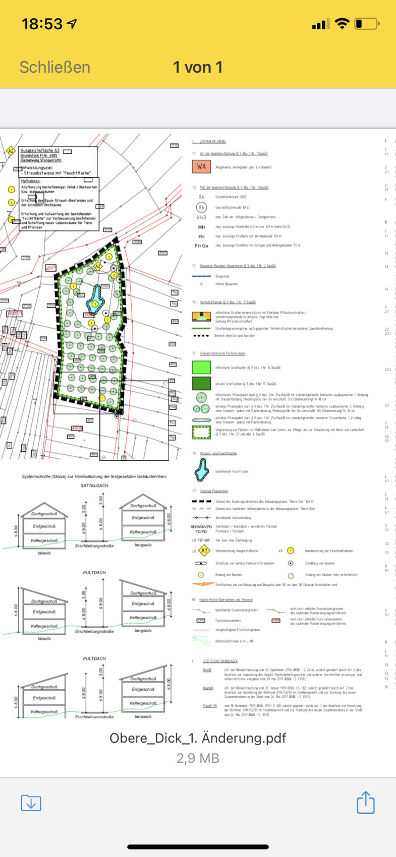

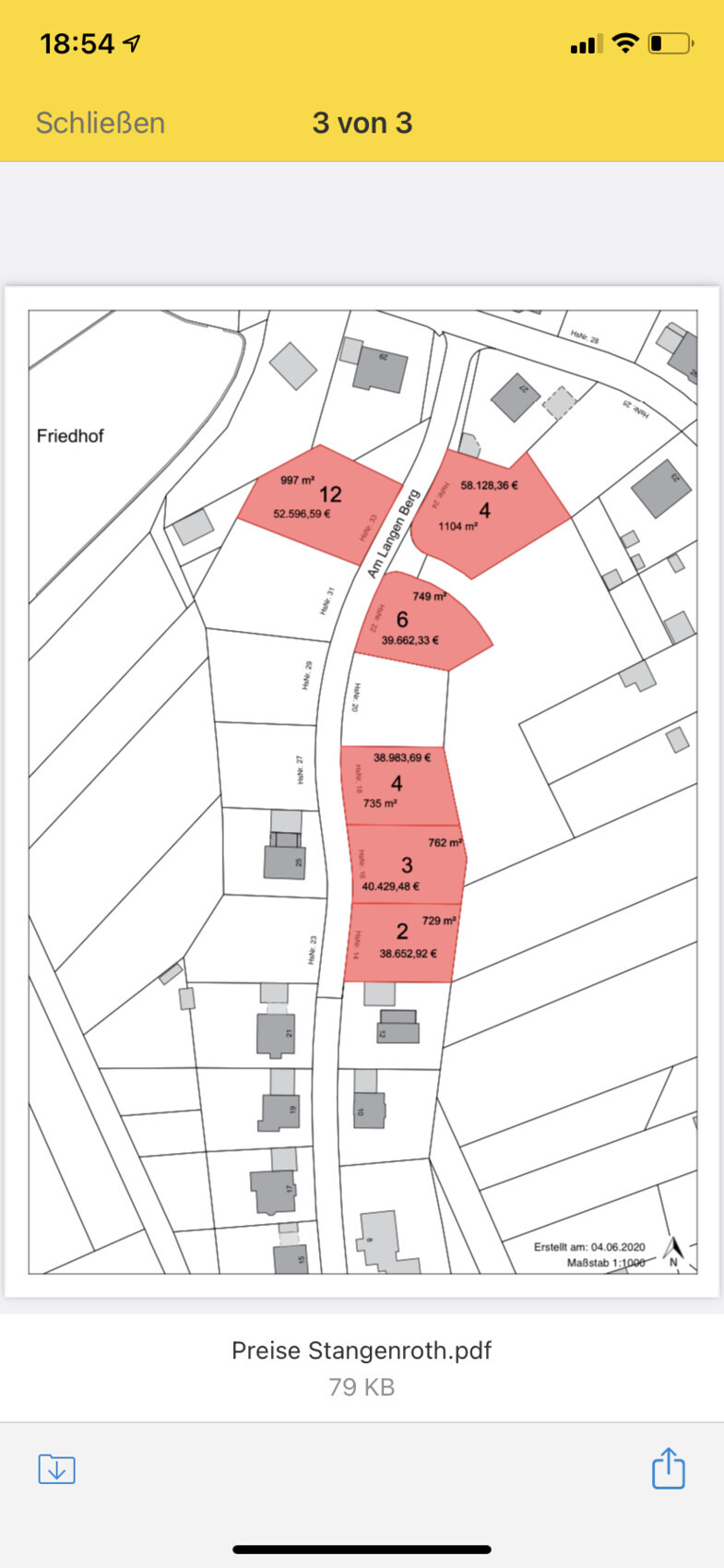

lisa-kessler20 Oct 2020 18:51ypg schrieb:
Could you please share again what the zoning plan specifies or allows?
The zoning plan is completely open. I will upload it as well.
What about the site plan? Can you add the building envelope and dimensions, and also include the slope!!! – very important – in the drawing? How much slope affects the building envelope? A simple sketch is fine.
This is important because you can already see that the house is situated on a slope on the east side. What is planned for that area?
I can upload the site plan.
