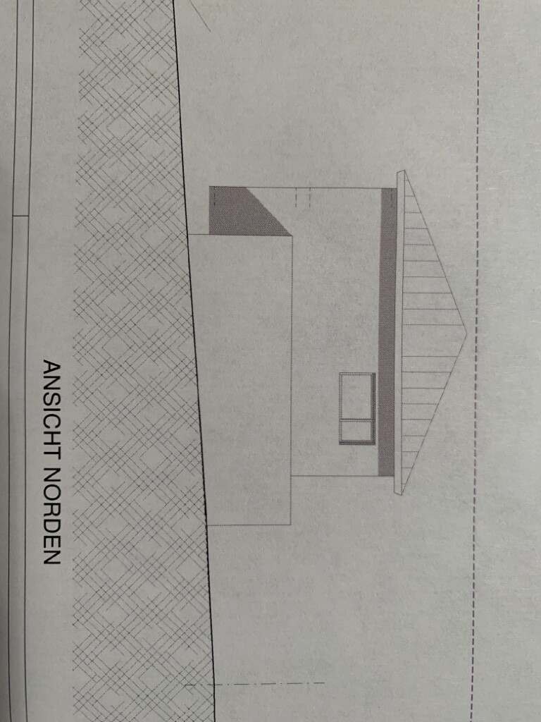

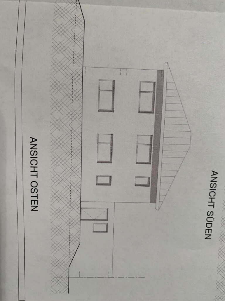

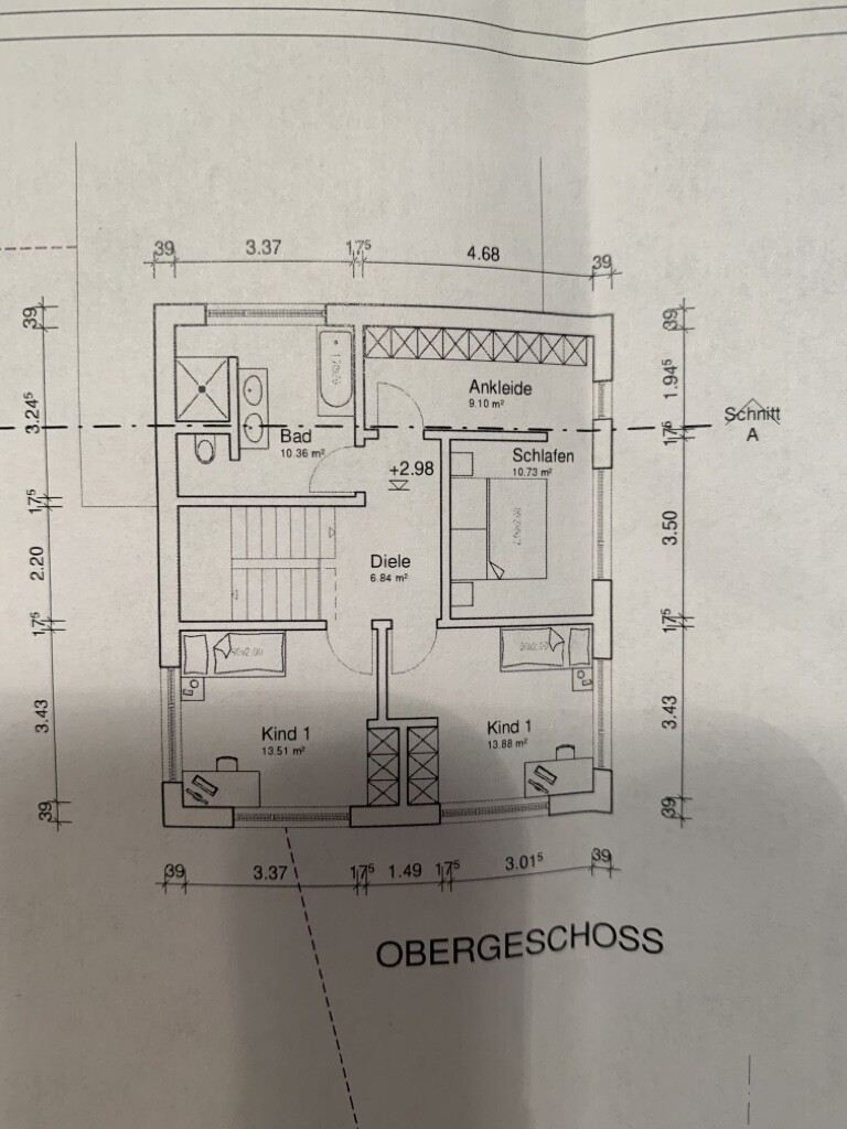

Today we received the first draft from the architect.
Plot size: 735 m² (7,908 sq ft)
Slope: yes, approximately 2 m (6.5 ft) decline along the entire length
Boundary development: yes, the garage is built on the boundary
Number of parking spaces: double garage with cellar replacement room
Number of floors: 2 full stories, no basement
Roof type: hip / pyramid roof
Style: urban villa
Orientation: see plan
Clients’ Requirements
Basement, number of floors
2 people, 27 + 29 years old, no children, with a Chihuahua
No office planned
Few to no overnight guests per year
Modern construction style
Open kitchen, kitchen island
4-6 dining seats
No fireplace, only underfloor heating
Terrace and garden
Garage, carport
Planner: architect
What is not liked? The clients are currently not 100% satisfied with the front view because some parts are without windows
Preferred heating system: air / heat pump
Why is the design like it is now?
Preliminary discussion with the architect, who has already visited the plot
The large sliding window was initially planned on the south side but can also face east.
That is why no terrace is drawn in yet.
The garage roof was set lower than the house roof so that it is permitted as a boundary garage.
Now, please jump in: what would you do differently and why? What do you think is well solved?

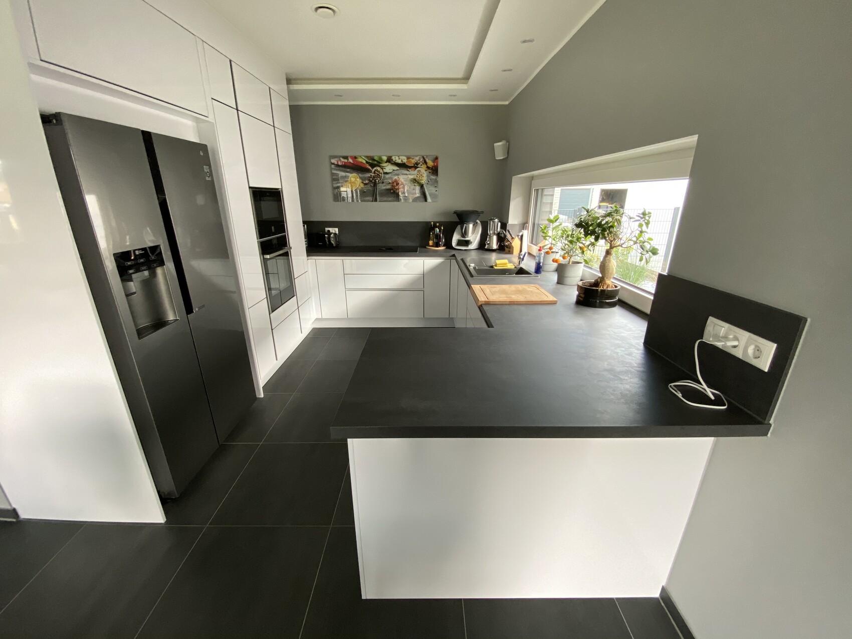

Golfi90 schrieb:
Here is 4m (13 feet) as a comparison.Have you also hidden indirect lighting in the suspended ceiling element?
KEVST schrieb:
Did you also hide indirect lighting in that suspended ceiling element?Yes, we did.
The same applies to the kitchen.
The spotlights can be dimmed in three levels using a switch.
