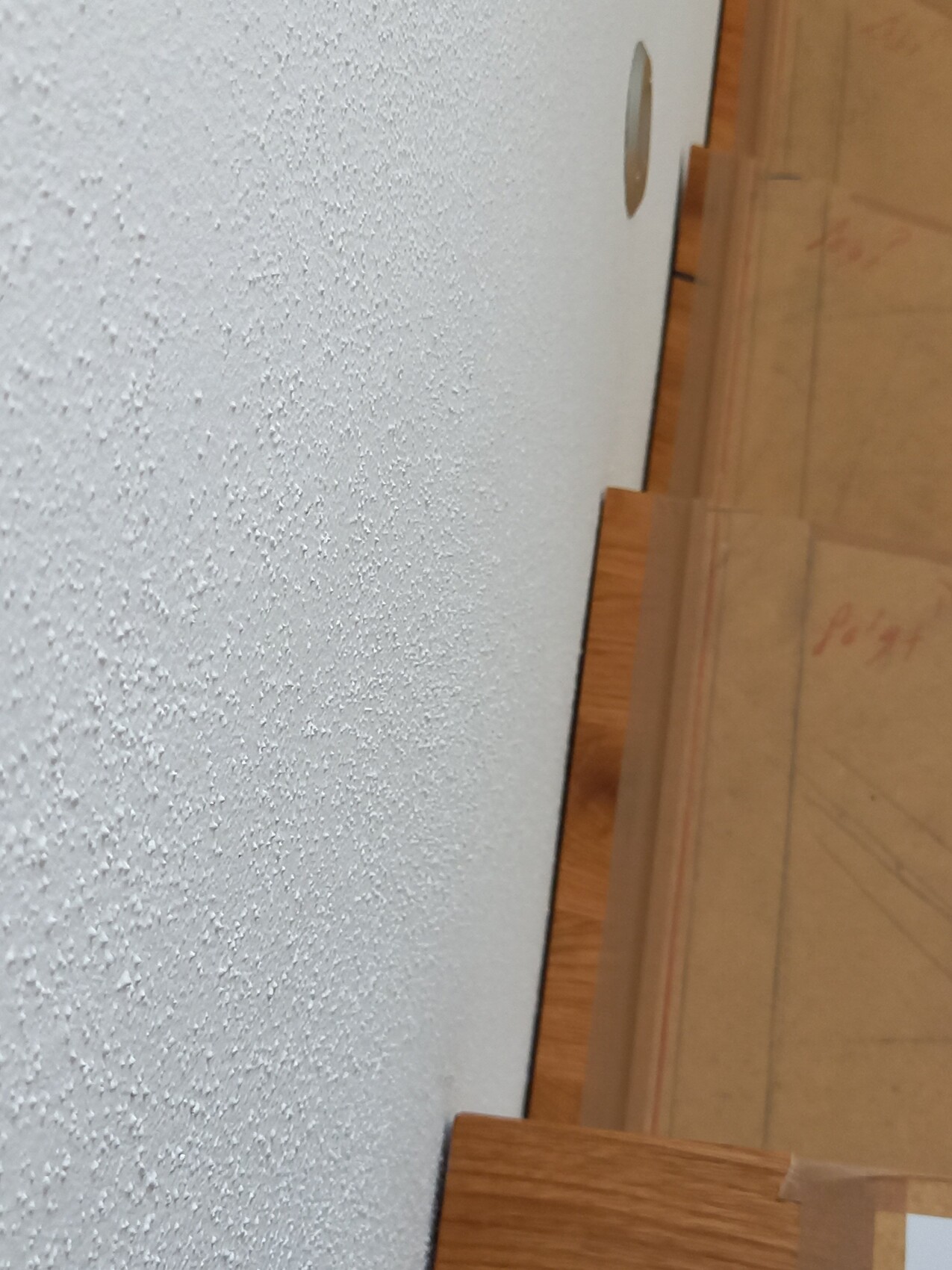

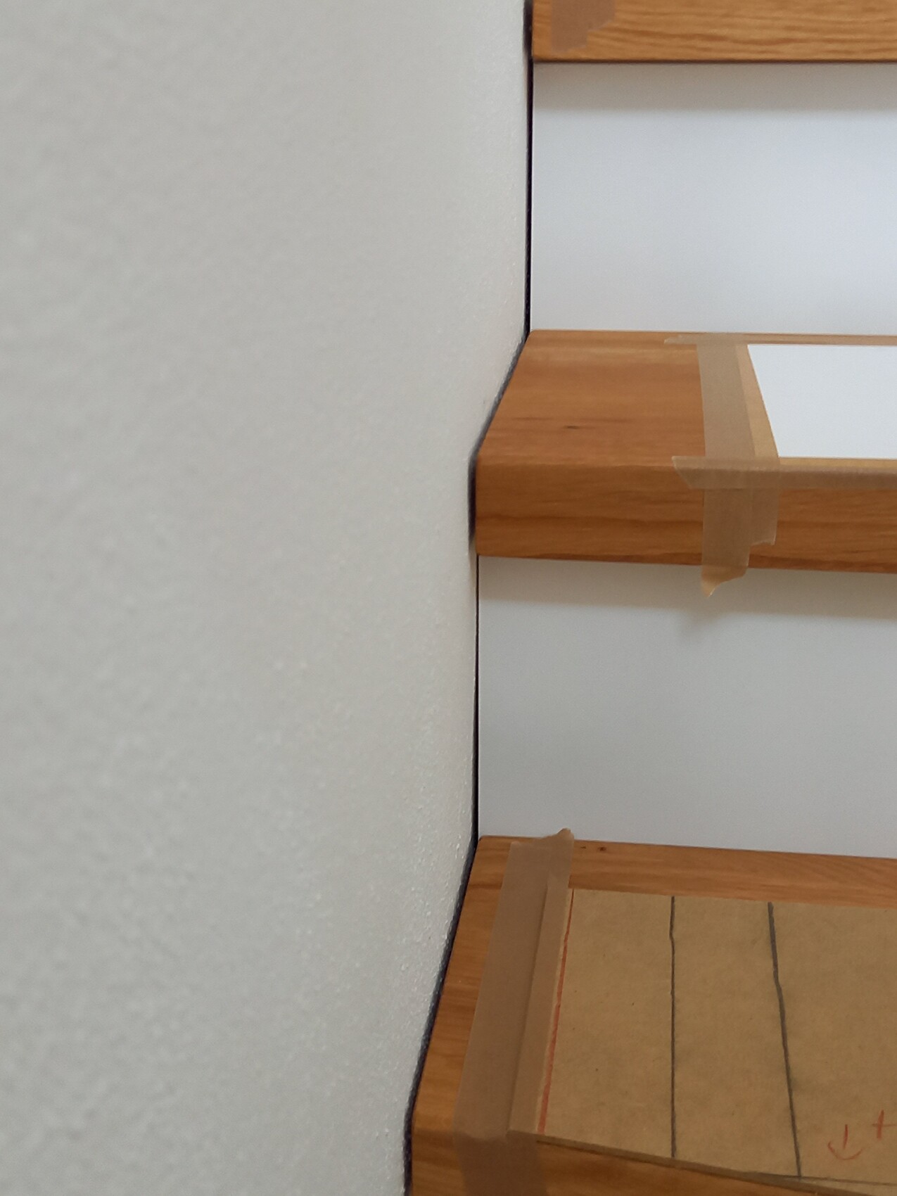

Our staircase was delivered and installed. Treads and risers were screwed onto a steel staircase.
Now there are small gaps on both the left and right sides.
Is it recommended to fill these with acrylic? (For cleaning and appearance)
Or is that not advisable, since the wood might still expand and contract?
Wood staircase with tape on the edges; cardboard covering on the bottom step; gray wall on the left.
White, coarse-textured wall next to a wooden staircase; hole in the wall.
Tolentino20 Jun 2022 20:06
Better to use silicone because it is flexible. However, make sure it is compatible with wood. As far as I know, it should not be "acid-curing" (vinegar-based) but rather neutral-curing.
