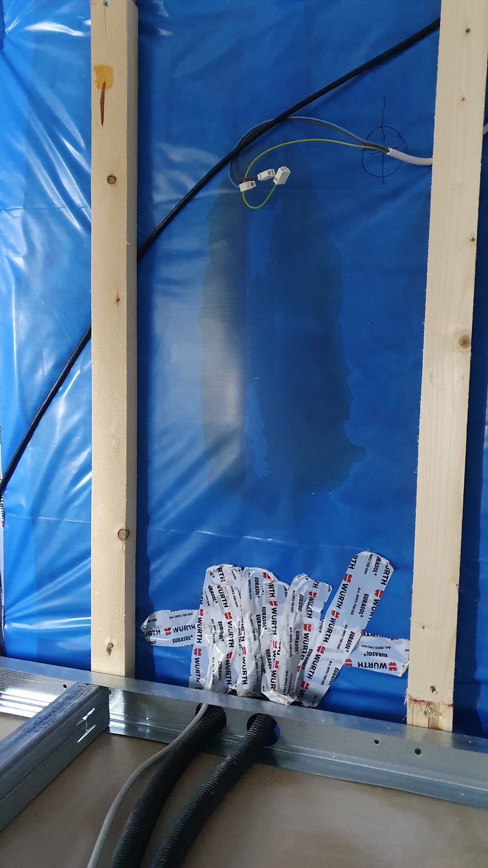

Under our cold roof, moisture is accumulating to the point that a puddle has formed above the vapor retarder. This means the insulation wool is likely already quite soaked. We still can’t access the cold roof because the screed hasn’t been installed yet. I can hardly believe that water is coming through the roof; it’s more likely that the vapor retarder is leaking and moisture was pushed through during the drying of the screed. Naturally, this raises concerns about mold on the roof structure. I’m trying to stay calm and am writing another defect report.

Oh man, when things go wrong, they really go wrong. But things have to get better again sometime! Two months ago, a left-turning driver crashed into our Vito. We were not at fault at all, repair costs are over 10,000 € and according to the other party’s insurance, the vehicle value is 3,800 €, which means a total loss financially. But that’s not true, since it would cost at least 8,000 € to replace. The vehicle is now parked in the driveway and can’t be used because it’s not roadworthy. I can’t leave it unrepaired either. So the lawyer has to get involved again. At least does your comprehensive insurance cover it?
Could it be that the roofing membrane isn’t watertight if the water is sitting above the vapor barrier? We had that issue too.
And also a leaking vapor barrier. You can check out the pictures in my thread “Drywall and vapor barrier done differently.” We had to remove all the drywall again. I understand how you feel. There were times when I didn’t want to go to the construction site anymore.
From this perspective, I don’t think a painting consultant makes much sense anymore. You need someone who looks at the entire problem and can also provide a financial estimate. Get yourself ready for the idea that your move-in date will be delayed, even if that’s hard to accept.

As has been mentioned elsewhere: expensive materials (Würth sealing tape) are no guarantee of correct installation.
To me, it looks quite sloppy. However, I can’t see the details of how the cables are ultimately sealed or taped going in, out, or around the protective conduits.
What is correct is to apply cartridge sealant around the cable inside the protective conduit, and the conduit itself must be sealed and bonded to the vapor barrier. It looks quite wrinkled and carelessly (insufficiently) pressed in. 🙁
