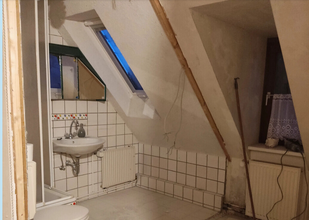

After deciding against converting a study into a bathroom, we have now confirmed that we will enlarge the existing bathroom in the attic of the house.
We want to turn a small shower room into our new main bathroom.
As you can see in the pictures, the wall has already been removed. Now a new drywall partition will be installed.
The goal is to have a bathroom with a larger, walk-in shower, a toilet, and a large washbasin.
I have attached an initial layout plan.
The fresh water pipes are located in the rear right corner, and the drain pipe is inside the chimney.
We plan to tile the shower tray, and the enclosure at the end of the shower is intended to be used as a sort of footrest.
At the moment, we can't think of any other layout that would make sense. Do you perhaps have any suggestions?

hanghaus202325 Nov 2023 10:36You have a toilet with a floor waste outlet. Converting it is a real challenge.
If it were mine, I would build a new knee wall at the height of the windowsill. This would immediately create a calmer feel in the room and conceal the heating pipes at the same time. Then I would try to route the toilet pipe behind this drywall partition. The pipe would probably need to be routed around two corners for this. It’s best to ask the plumber if they can manage the necessary slope.
I would extend the shower across the entire width of the room, including the roof window. The washbasin should be placed next to the door with a continuous cabinet underneath, which should be roughly at the height of the windowsill.
The effort would probably be quite high at first because of the toilet. But if this is going to be my main bathroom, it would be worth it to me. However, if the plumber can’t work out the toilet installation, then the plan is basically useless.
