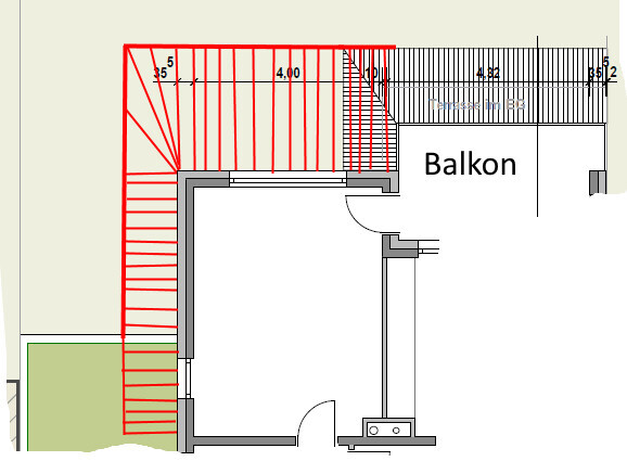

As usual, you only notice some of the less optimal aspects once you’re living in it. In my case, the living room is too small, so I would like to enlarge it. To do this, the basement below would probably also need to be expanded (at least in one direction), otherwise I would have to block up the basement windows. I did a quick sketch to show what that might look like:
As you can see, part of the garage would have to go. For the roof, I was thinking of a simple pitched roof that would connect to the main wall of the upper floor.

Here is the ground floor plan again: You had your chance to teach the basics. I won’t say it again and now I’m off to eat the cookies with Yvonne myself.

The windows in the basement are quite a problem. Is the basement room officially considered living space? You will probably have to close the windows, and the room will then officially be downgraded to a cellar or storage room. (What you actually use it for doesn’t matter.)
On the ground floor, the loads from the upper floor need to be properly transferred downwards and outwards. Would you be okay with having one or two columns in the living room?
You definitely need a qualified architect and a structural engineer for this.

The steel beam is 6 to 7 meters (20 to 23 feet) long. It has to support not only the ceiling but also the floor above and the roof. It will be large and heavy. I’m not sure exactly how big, but let’s say around 25 cm (10 inches) in height plus casing. Would something like that be acceptable for you? I think it might look unusual since you would need one over every existing wall, creating a sort of recessed "cross" in the ceiling. What ceiling height do you have?
