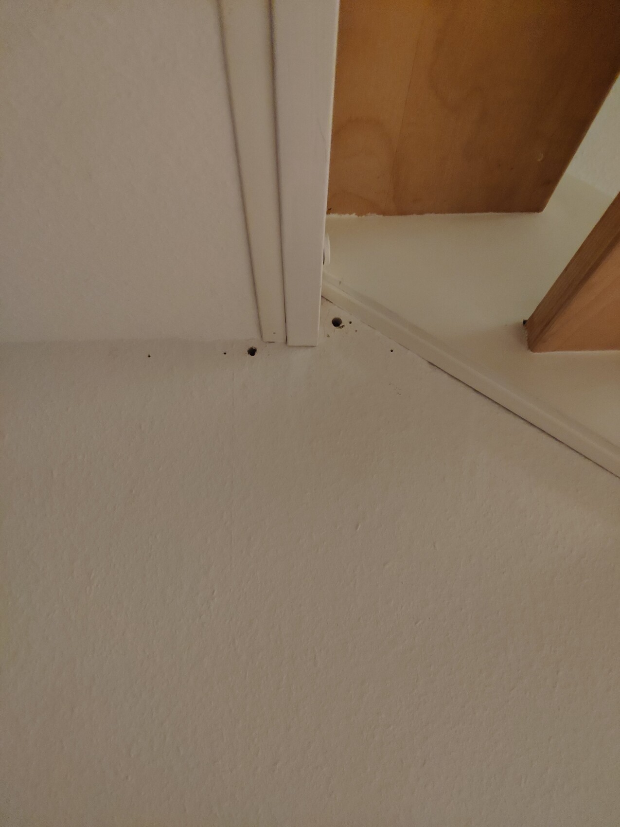

Why not post a picture showing where you plan to drill? That way, it might be easier to help you!

Hello, here is a picture. I drilled in two spots but encountered harder material each time and was unsure whether I should force my way through.
White floor, door frame on the left and wooden door on the right; several dark drill holes on the floor.

Maybe you have come across a beam there!?
