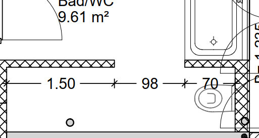

Designer:
- own design (wall thicknesses roughly assumed: exterior 40cm (16 in), interior 20cm (8 in))

- location of bathroom upstairs is above ground floor office → drainage difficult & noise issue if used as a bedroom later.
- kitchen relatively small, but acceptable compromise due to the long shelf wall in the utility room as backup for fryer, pantry, etc.
- bathroom with T-layout at 3.6m x 3.6m (12 ft x 12 ft) almost too tight
- technical room only along a 3.6m (12 ft) long wall and in the middle of the house (long supply routes regarding connections) → questionable if feasible

Kreisrund29 Mar 2025 08:32There is a lot of drying on racks around here However, this should no longer be the case in a new build. It’s harmful; where is the moisture supposed to go? Mechanical ventilation systems provide fresh air to the living areas and extract air from the wet rooms. You need to plan accordingly.
For this exact reason, we have exhaust ventilation in the walk-in closet. Otherwise, how else are you supposed to dry clothes? Only a small amount of laundry can go in my dryer because most fabrics are not suitable for it.
Kreisrund schrieb:
We have exhaust ventilation in the walk-in closet for exactly this reason. How else are you supposed to dry your laundry? But there is no walk-in closet here. Basically, it’s important to consider these kinds of issues when moving into a new build. Everyone has their own way of drying laundry. New dryers or even machines that are 10 years old can be set to gentle drying. A small rack in a humid room is also an option, otherwise outside. You just have to adapt and not stick to old habits.
If you change even a small part of the plan, it often affects the entire layout. You adjust something here, and something else shifts there... don’t let that alarm you.
I still encourage you to draw on graph paper and use accurate measurements. For example, in the shower I don’t see a wall section, which should be there if you don’t want glass, and that usually has a thickness of about 70mm (3 inches); you shouldn’t just “leave that out,” especially in a tight bathroom layout where these details can be crucial.
My own plot is much larger, but that didn’t make the planning any less complex.
There are always multiple alternatives if you let go of unnecessary fixed ideas in your mind.
Then I wouldn’t build it that way, especially considering your existing interest in working on cars, which is important to you. Or you could rent a suitable space nearby permanently. Generally, I’m not a big fan of garages (mainly due to their high costs, which often cause financial strain elsewhere), but if you’re a car enthusiast, that’s a different matter.
It’s good that you already recognize this “over-focus.” Not only does this change with time, but children don’t need lots of extras from the start to develop well. I’m still waiting for the study that proves that the thousands of trampolines in suburban gardens have contributed more positively to development than simple play in the sandbox.
I know families where 12-year-olds were allowed to choose the building site or influenced things like window shapes and much more.
It doesn’t need to be completely ignored, which is why I’d build a house that works well for me as an adult, too, and can still be comfortable 20 years from now. I fully understand that children will eventually leave your home and build their own lives, but until then, they live in a beautiful house with their own spaces. This already puts them in a good position and they often need more interpersonal experiences for healthy development.
Trends in homebuilding are irrelevant since they are temporary. The question is whether you simply copy a trend or whether you apply something useful based on your own life circumstances. I never had a “children’s bathroom” typical here; rather, a parents’ bathroom or an area that offered clear privacy for the adults. Conversely, I didn’t just walk into the children’s rooms without knocking first.
Since you wanted to separate spaces here, I thought teenagers might one day have their own bathroom or area, creating privacy both for them and for you.
A mistake we made many years ago — and which I now laugh about — is that you shouldn’t just imagine life with small kids, but also, even more clearly, with teenagers who might be confrontational or unwilling to listen; having some distance in the house can be beneficial for everyone. If it turns out differently, that’s great.
So no to that and no to anything else? Why is it then shown on the plan? It is actually difficult to predict how some things will function in practice. There are two of us and we recently had the luxury of two bathrooms, which I liked. In the new house, I am using it differently than I expected—I don’t know why. But if it weren’t there, I know I’d miss it, knowing myself.
Show us your drawings. I don’t see any real disadvantage to pencil and eraser. On the contrary, I know people often waste time wrestling with technical constraints of a system or its limitations. But it’s clear you haven’t included many measurements that could make your specific project fail (wall thicknesses, supporting walls, door widths, dimensions of fixtures...), so until then it’s just a pretty exercise. For example, if the shower doesn’t fit there because you overlooked an 8cm (3 inch) difference, the bathroom layout will fail or other changes in the building plan will be necessary.
And... speed is definitely not an advantage during building planning; accuracy is much more important!
I understand that your thoughts always follow a specific intention. However, there are usually several needs, and these do not disappear just because one of them is addressed.
No—that's not correct. It became that way because you were stuck on some other issues or have reached planning limits (which is understandable).
So far, it sometimes sounds to me like you’re saying, “I know it’s not good or pretty, but I had to build it this way because there was no other option.”
As with the planning app versus drawing, I also read “wasted” time here. I see it differently and believe that you have to go through many things yourself to get closer to your goal. Is someone or something pushing you or feeling time pressure? Enjoy taking your time on individual details to be able to enjoy them for a long time afterward.
It is indeed difficult to free yourself from such emotional assumptions, and I keep reading about them here. I would always want to see it as a purely factual decision either way, depending on the plot, intended use, and costs.

schrauberlouis29 Mar 2025 12:21Thank you for the additional responses. Since many points are similar, I will reply more generally now without quoting (apologies if I miss anything).
Of course, I don’t see myself as an architect apprentice and I welcome all criticism as well as positive feedback. I also don’t want to save on the architect at all costs and simply pass my design to the general contractor or draftsman. However, when I look at houses or floor plans from independent architects within my circle, I often wonder what they were actually thinking. So it is extremely difficult to find one that fits our needs. To avoid hundreds of iterations and wasting large amounts of money and time, I chose this approach. By the way, we also had a detailed preliminary discussion with an independent architect, but the first ideas there were also disappointing.
In my previous answers, I focused too much on explaining the background as thoroughly as possible, without emphasizing again that our main concern is the general orientation, room layout, and basic concepts. So more like a “preliminary draft.” Of course, I drew the floor plan as accurately and completely as possible with to-scale furniture that we either imagine using daily or already have. Yes, I mistakenly planned the wardrobes as 50cm (20 inches) deep instead of 60cm (24 inches). Also, the wall thicknesses were roughly assumed as 40 / 20cm (16 / 8 inches). I did not focus on the last 10cm (4 inches), but I believe it still works. Of course, a professional plan would need to check all functions in detail.
The same applies to the bathroom. I think something usable could come out of a roughly 3.6x3.6m (12x12 feet) room by experienced planners. For the T-layout, I lack the technical know-how, such as how wall thicknesses of wall partitions behave and what the detailed dimensions would be. But yes, in the planning phase, an unpopular glass solution would probably be necessary. Although I was hoping that with a 1.8m (6 feet) length and 0.7m (28 inches) access in this configuration, the splash area would be manageable.
Regarding drying laundry without a dryer: A controlled residential ventilation system is on the wish list, and I had assumed (with proper planning) this would be no problem.
But here I have already drifted too far into details again. Please see this as a somewhat more detailed “preliminary draft” and therefore back to the basics, why the compromise of the narrow garage was made and why I mentioned the larger plot:

I may have mentioned before that my wife drew about 100 DIN A4 pages, continuously changing them. She copied a floor plan template multiple times and then constantly pieced them together. If you want to do that yourself—as we did—you’ll need a lot of energy and accuracy. Otherwise, you go to an architect and let their creativity take over. We had a very weak general contractor, but at least he kept updating our ideas in his software so we could move forward.
schrauberlouis schrieb:
I didn’t focus on the last 10cm (4 inches), but I still think it works. No, it doesn’t, but there is still enough space to create a finished architect’s plan, which, of course, you don’t have to make yourself. It’s difficult for outsiders to understand your plan. Important details are missing, like door widths, all sorts of distances inside the living area or bathroom, the number and measurements of the steps (do they even fit? what is the floor-to-floor height?), etc. People don’t want to keep searching the entire thread for those details, and if I don’t have a dimensioned plan from the general contractor, I have to create it myself. You need to provide maximum information to make it as easy as possible for the building authority (municipality) to imagine the project or to compare it with their own standards and give feedback.
You said you already received drafts or sketched something yourself—please share that. Maybe something useful will come from it. By the way, I wouldn’t plan with doors smaller than 1 meter (about 3 feet 3 inches).
If you don’t want glass in the shower, I totally understand—that was also my requirement for our current house. It works very well, looks good, and is affordable. In your upstairs bathroom, it could already be implemented if you swap the toilet and the shower. You can see it in this excerpt, and it really is comfortable in every way.
