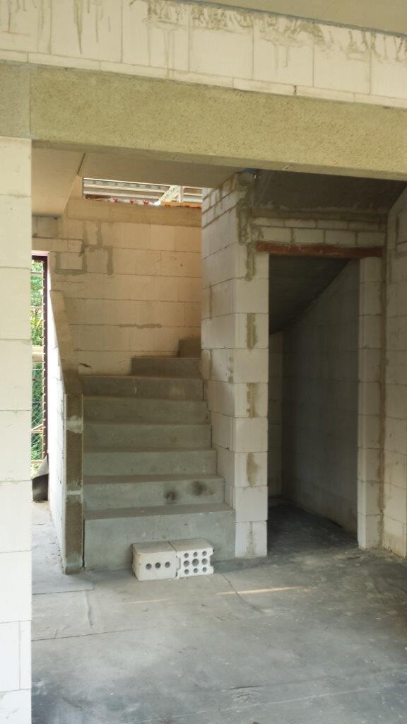

Would you still keep a wooden staircase if you combine the entrance area and the hallway?
Has anyone ever seen a pantry under the stairs like this? I’m asking again because I can’t quite imagine how it looks from the outside.
We will definitely mirror the layout (but I would prefer to keep the garage on the north side). Mainly because of the shorter walk from the carport to the door.
Oh, right – then it wasn’t Toxi... it was Manu. He also posted pictures of it here: https://www.hausbau-forum.de/threads/treppengelaender-auge-und-abstellkammer.13112/
I realize again that we still have a lot to do – it looks much nicer at his place than it does at ours right now 😀

toxicmolotof14 Aug 2015 20:46No, it wasn't me, that's where my coat rack and the litter box are. Although I do find something like that quite nice.
