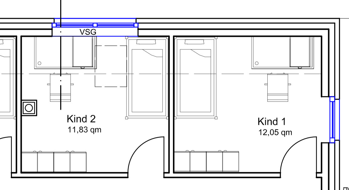

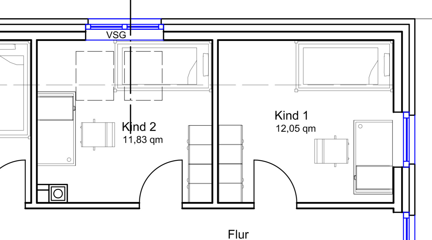

As mentioned, this is just an example, but if it is a square room, the question about the necessity as well as the advantages and disadvantages arises. Here are some possible options from our current design:
Floor plan of a hallway with two children’s rooms (Child 1, 12.05 m² (129.7 sq ft); Child 2, 11.83 m² (127.3 sq ft)) and furniture.
Floor plan: two children’s rooms with beds and desks, doors; approx. 12 m² (129 sq ft) and 11.8 m² (127 sq ft)

Your wife is right. Cabinets behind the door make the room feel more spacious, especially when floor space is limited. Add a shelf to the room drawing. Child 2 is quite dark.
Ibdk1415 Dec 2020 09:14
Hmm, Child 2 does have a window and a skylight. Child 1 is somewhat at a disadvantage in that regard.
A downside of having the cabinets behind the doors is that you can only open the cabinets when the doors are closed. This can be inconvenient. Otherwise, it works better for the overall room layout.

I would move the door for child 1 to the left, as placing it in front of the window is inconvenient.
Whether to have a gap from the wall or not is a matter of personal preference.
I prefer the lower options – without a gap.
