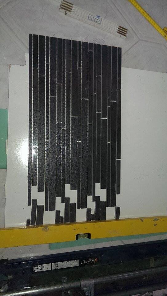

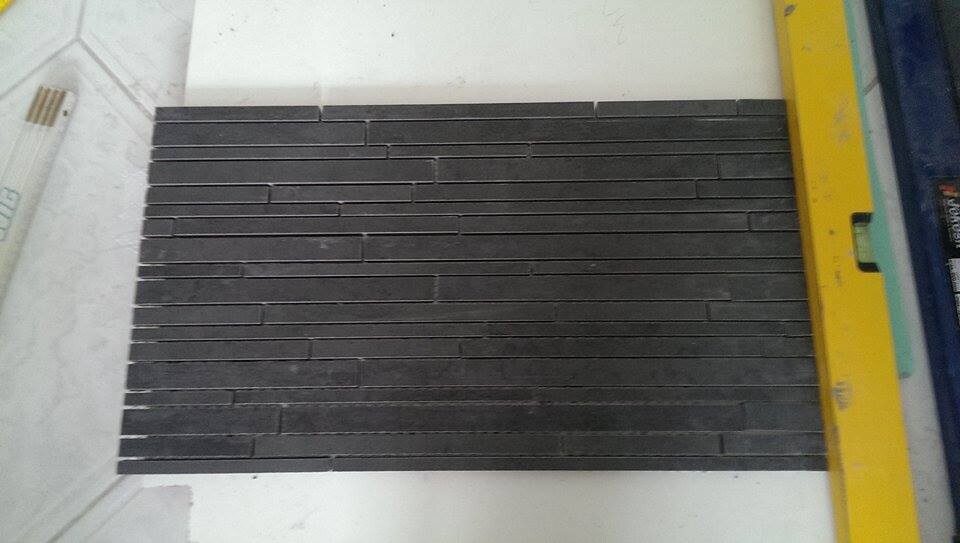

I bought 8mm (0.3 inch) stick mosaic tiles and am having serious trouble breaking them straight with a regular handheld tile cutter. When I try to snap them near the ends, the thin sticks often break on the longer side.
Would you consider investing around €160 (about $175) in a wet saw, or keep trying with the manual cutter? To be honest, I’m not sure how professionals handle this. Do you have any idea?
I also had trouble when applying the tile adhesive horizontally. I noticed that the strips of the stick mosaic fold into the ridges and don’t lay completely flat. Now I apply the adhesive vertically and create small waves to prevent the tiles from slipping. But it’s definitely quite tricky overall.
I would appreciate any tips and tricks. Stick mosaics are harder to find online compared to regular mosaic tiles or other tiles.

nordanney8 Sep 2014 12:47Just use an angle grinder, the tiler uses one as well. With a bit of practice, you can achieve perfect cuts – but be careful with your fingers, the grinder cuts through like butter.
For pressing down, you can also use a flat object (e.g., a spirit level, board, or similar).
Good luck!
Good luck!
nordanney8 Sep 2014 14:17Why use flexible adhesive? Because it’s much easier and especially faster for tiles like these (as well as mosaics and corners, etc.).
A wet saw is typically used for tiles that cannot be cut with a manual tile cutter anymore, such as thick or large granite tiles.
Well, a wet saw is basically just an angle grinder with water cooling... To be honest, I don’t feel confident using it, especially to cut fleece or other materials neatly with the grinder. Besides, having a frame means I don’t have to work with a lot of dust on the floor.
I just thought there might be a different tool, and that this might be too much for my 3-room apartment.
But thank you very much.
