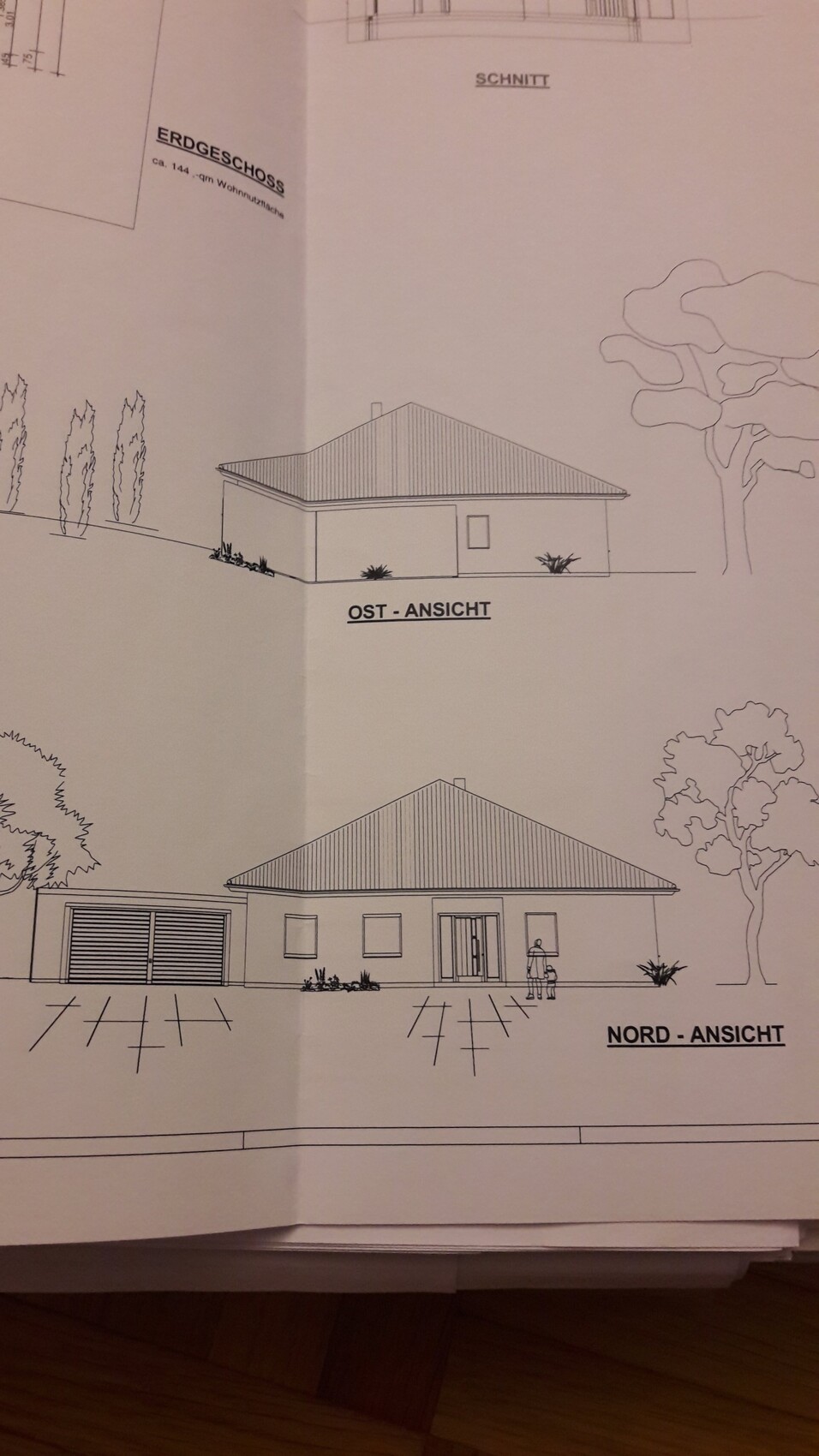

That sounds like a planning error. In theory, the eaves would intersect with the garage. That’s why the house roof is now supposed to flow around the garage, meaning the eaves will be raised by shortening the roof overhang. Where the two would meet, several rows of roof tiles at the bottom will be cut accordingly.
It sounds odd, but with garages procured by the homeowner, this is probably not an isolated case. Since it won’t look “nice,” I would rather lower the garage a bit. However, at this point, it’s a bit late to change the plans. How much height difference are we talking about here?

Unfortunately, I don’t know which height you mean. I’m attaching our plans.

What does it have to do with us building the garage ourselves? The general contractor prepared the planning, foundation, etc. Then I don’t understand the problem: this type of conflict usually occurs when the general contractor includes the garage in the plan only as a rough placeholder because it was sourced elsewhere and does not coordinate their planning accordingly.
If some part needs to be notched out, it’s either because the garage is built higher than shown in the plan and/or the house has been built lower (or has a reduced ceiling height?).

The general contractor couldn’t show me how the notch should look. Just imagine the garage is higher. Then the roof must step back at that point, similar to a parking bay when viewed from above. The rafters along the garage will be shortened, and the gutter will be raised by one or more rows of roof tiles.
