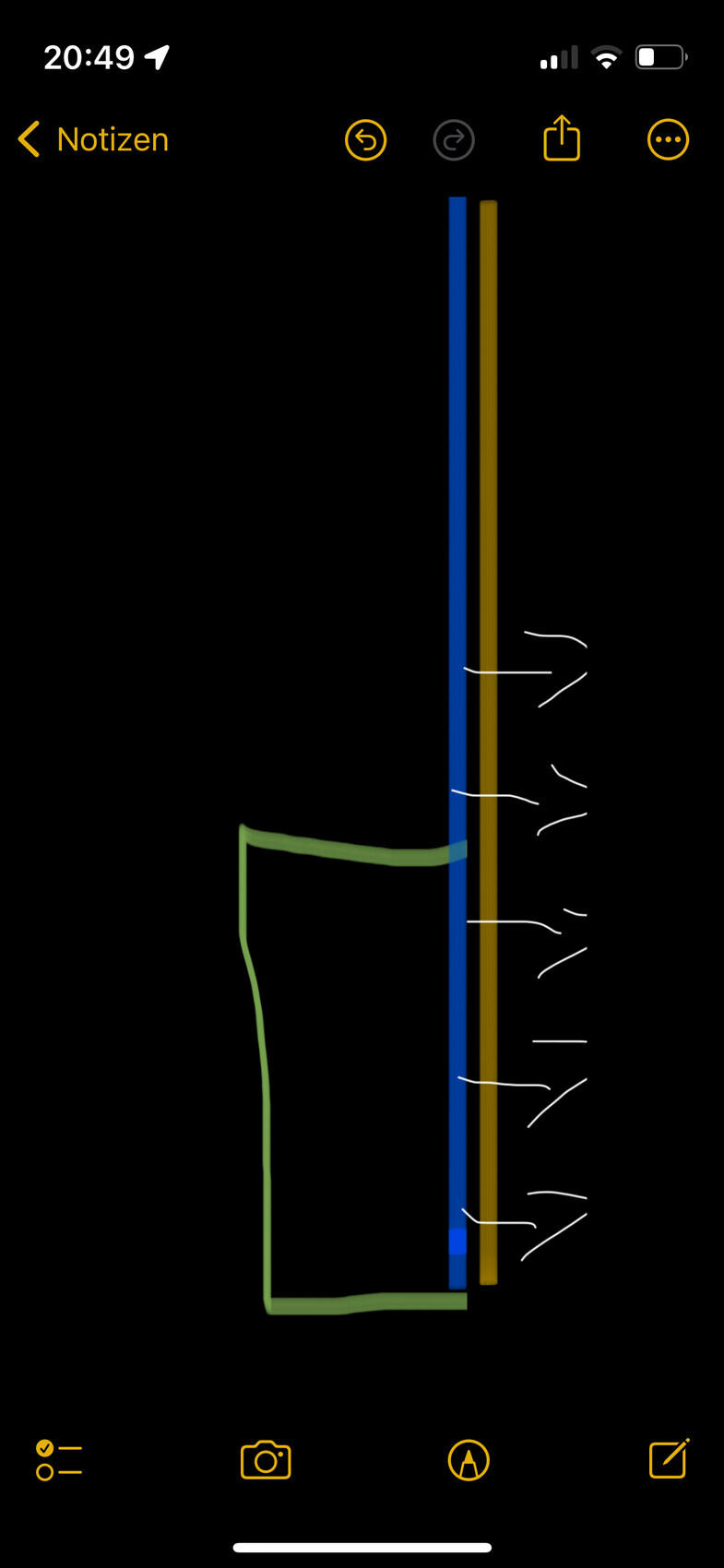

Here is a simple sketch:You could have also taken photos with the same phone and made a screenshot from Google Maps.https://www.instagram.com/11antgmxde/

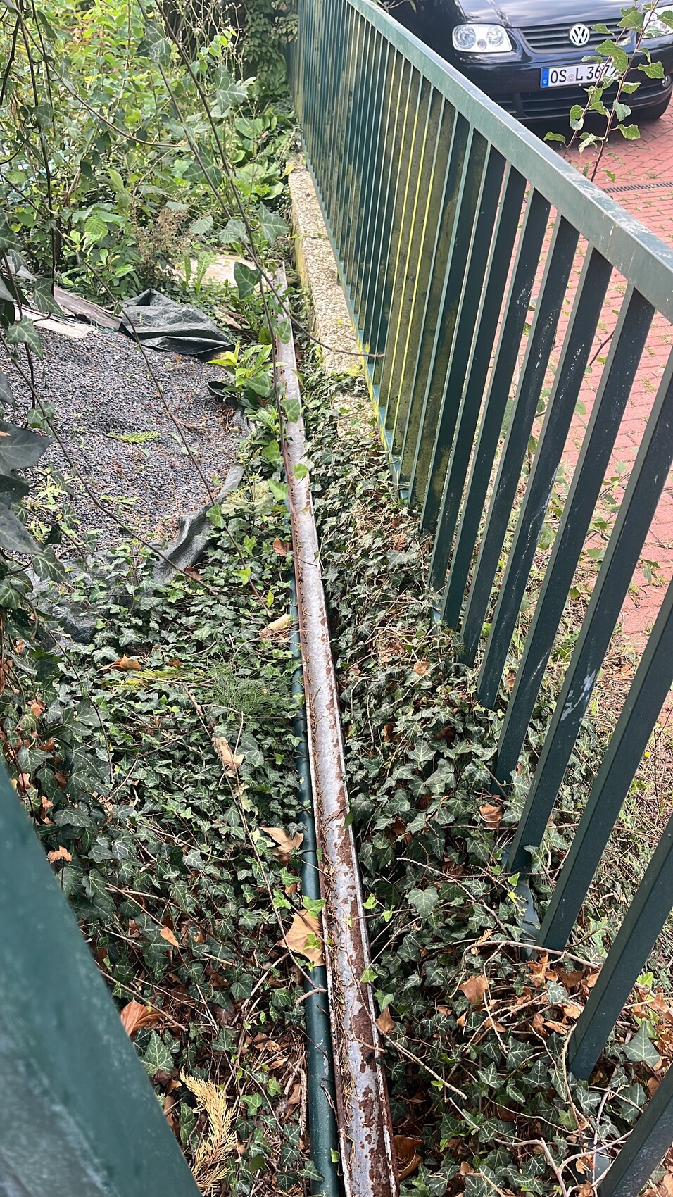

Alibert8713 Sep 2024 12:59I assumed a sketch would be more informative.. attached are the photos
