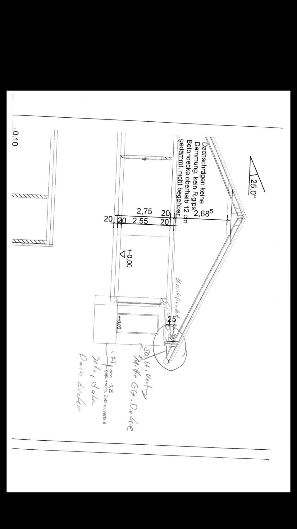

There is news... According to the general contractor, no knee wall was planned; instead, the 25cm (10 inches) mark is supposed to indicate the bending point. Is this correct, or is he trying to fool us? In his opinion, the height issue now results from a larger roof overhang, which he says he gave us as a gift. According to the plan, it should be 50cm (20 inches), but currently, it is 75cm (30 inches). He says he did this on his own because it looks better on a bungalow.
How is a knee wall usually represented in a drawing?
Is what he is telling us accurate?
Whatever is supposed to bend off from something. In the drawing, a hatch pattern looks like it could represent a row of stones or similar. But even just a wall plate (foot plate) could be possible—nothing is really clear there.
An additional 25 cm (10 inches) roof overhang at a 25° roof pitch naturally shifts the eaves by nearly 12 cm (5 inches).
A knee wall—which is rather uncommon without a living space conversion and also not typical at this height—can be identified as a wall segment below the wall plate (here unfortunately not clearly visible in the drawing). However, when looking at the attic floor, you can see if there is any "masonry" beneath the roof structure. The knee wall is measured from the top edge of the floor (though inconsistently, whether from the raw or finished surface).
