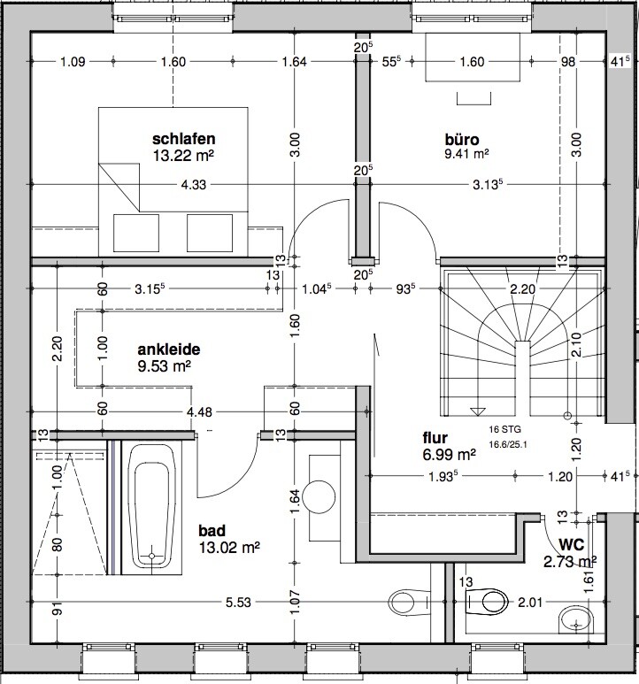

grinchmaster29 Oct 2015 22:23Ah, now I understand what you mean. I will include it in the further planning.

grinchmaster3 Nov 2015 22:07I currently have a concern.
The following points bother me about the master bathroom:
- From the bedroom, you have to walk an "S-curve" to reach the bathroom;
- The door swings against the bathtub;
- There is a lot of unused circulation space.
I could accept some of these issues individually, but not all together.
How could the bathroom layout be optimized?

You could place the bathroom door opposite the other door, but then you would have very little space for a large washbasin. You could rotate the bathtub or replace the bathtub with a smaller washbasin. However, I think it works quite well as it is. The door does not hit the bathtub. You just have very limited space because of the many windows...
grinchmaster4 Nov 2015 22:12Result of my considerations:
- Door opposite the bedroom door on the wall.
- Washbasin on the wall where the bathtub/shower are.
- Shower in the WC niche.
- Bathtub centered under the windows.
- WC to the left of the bathtub, at the bottom of the plan in the left corner.
The windows would need to be adjusted accordingly (possibly a partition wall to the bathtub).
What do you think?
