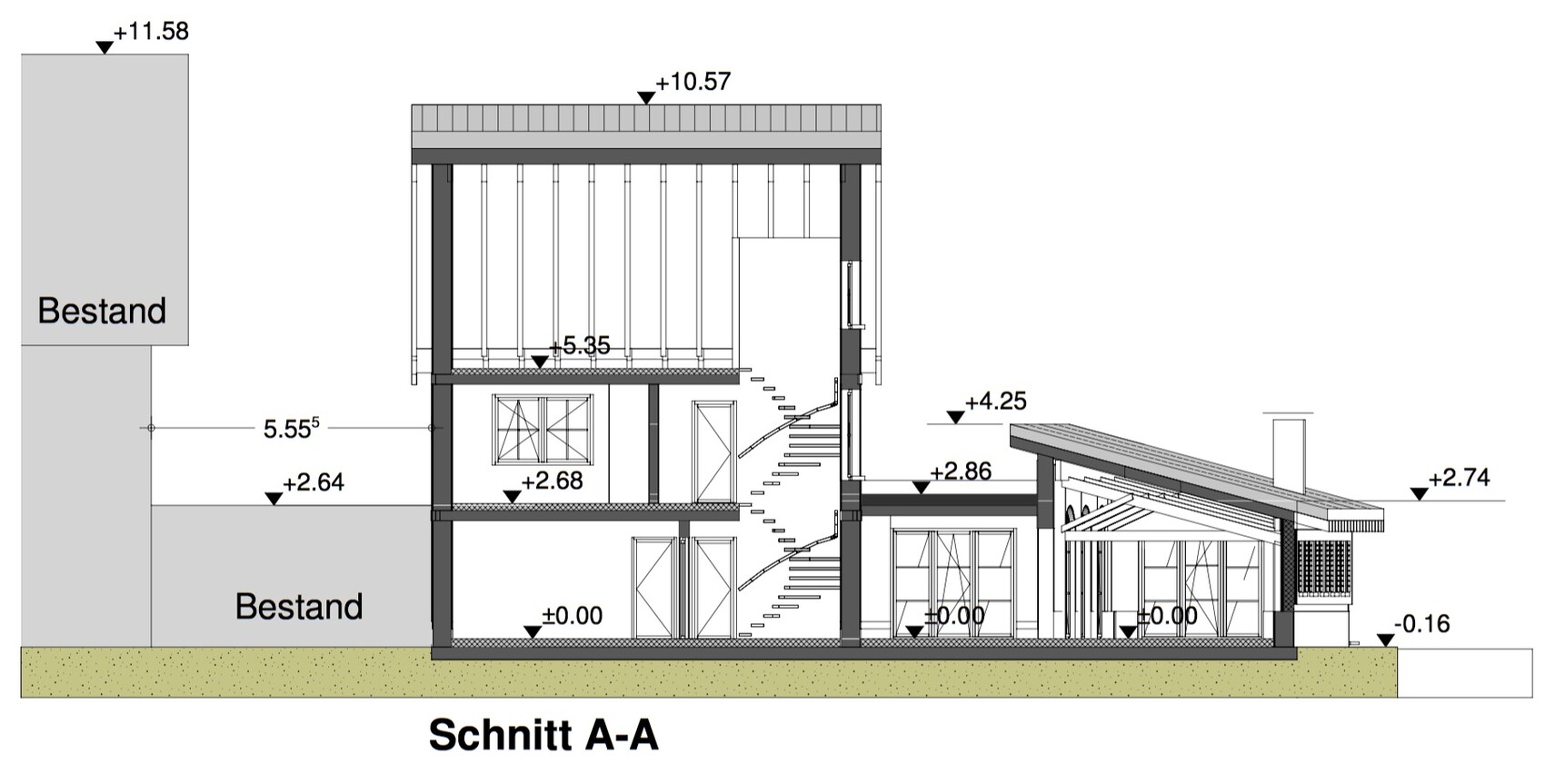

grinchmaster28 Oct 2015 22:22@Bauexperte: Thank you for your cost estimate.
Originally, I roughly calculated 1800€/m² (including additional costs), since a friend—who also built with the same architect—ended up at about that figure. However, he built in a modernist style and uses an air-to-water heat pump. I definitely do not want to spend 450,000. So that means tightening the budget.
The neighboring property owner (180m² (1,938 sq ft) house) had to drill 146m (479 ft) deep for his ground-source heat pump.
I’m attaching the cross-section. The wooden structure is indicated here.

grinchmaster28 Oct 2015 22:53The roof is this high to maintain the same pitch as the existing house and to visually match it. In the elevations, I have never noticed this negatively before.
Neither hay nor money will be stored in the attic. The plan was to convert it for the children if needed.
But of course, I agree with you that this is an area where cuts can be made.
