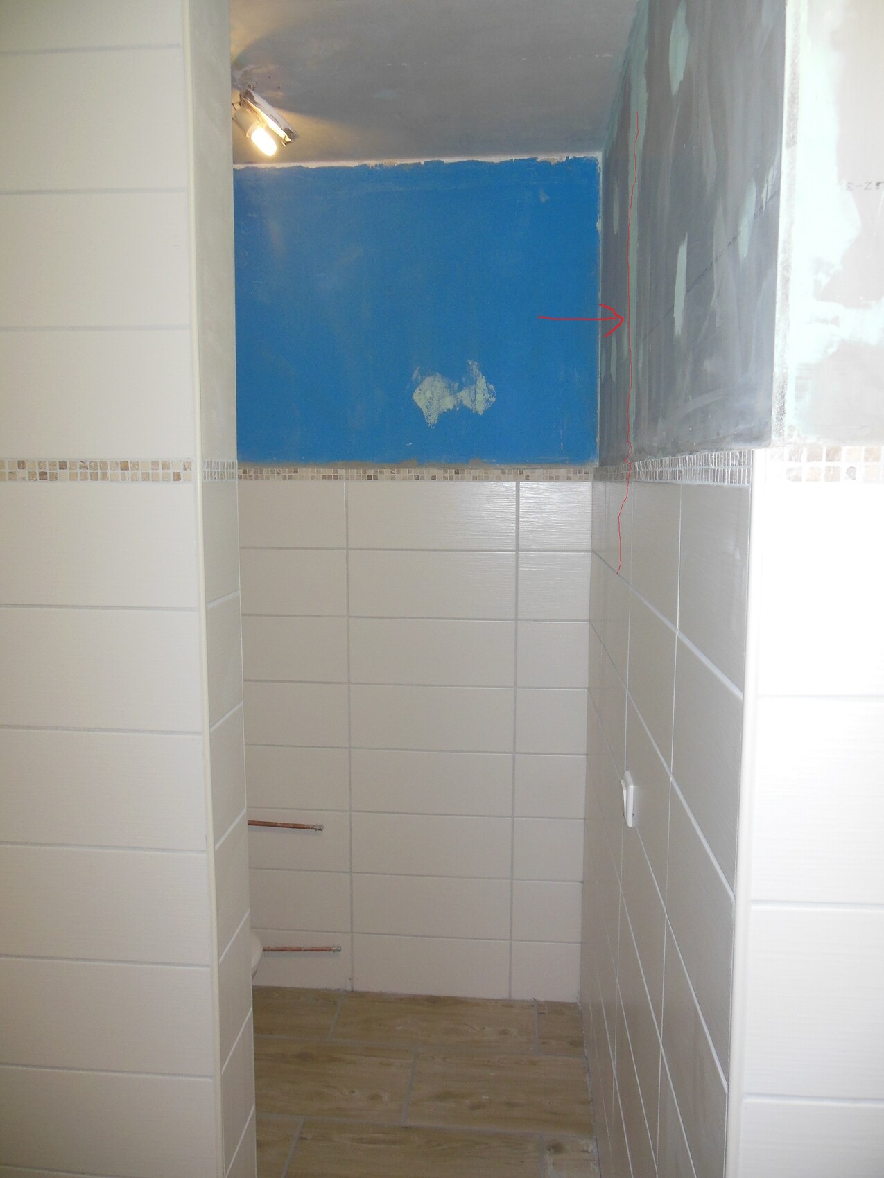

We have just renovated our bathroom and after a few weeks, we have noticed cracks in the plaster and tiles. I would appreciate your assessment and suggestions for how to proceed.
Conditions / Execution:
- Solid construction from 1971
- Old tiles were removed
- Fermacell Powerpanel H2O fixed to existing walls using setting adhesive and 80mm (3 inch) panel screws
- Screws and panel joints impregnated and filled with Uniflott, then surface sanded
- Tiles applied with Knauf Flexkleber Extra adhesive
- Above half of the tiles, plaster primer and roller-applied plaster were applied
The pictures show the current state with the crack positions before plastering.
We hope you can restore our confidence!
Mario and the co-builders

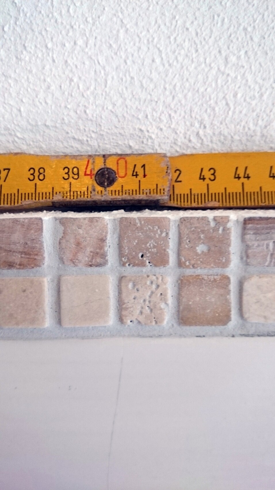

Mariohohh13 Sep 2016 13:32Attached is the photo showing the crack progression from the plaster to the tile.
Yes, we tiled it ourselves and apparently did not install any mesh tape there.
To me, the necessary steps seem to be:
- Replace the tile
- Sand down the textured plaster
- Apply crack tape with filler
- Re-skim the entire wall area
- Prime again
- Apply the wall covering
What is your opinion?
