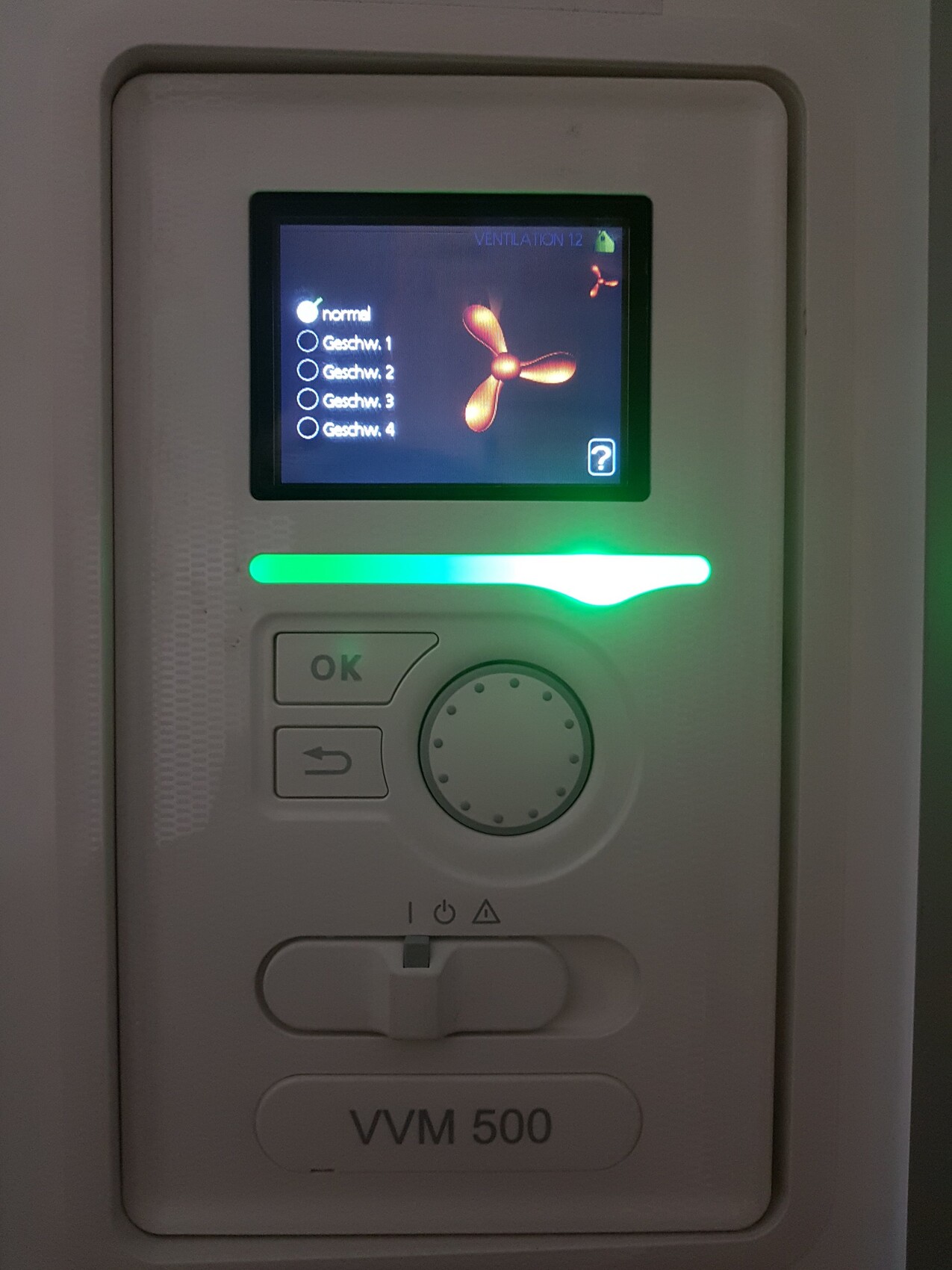

The ventilated living area is 165 m² (1776 ft²). Yes, the ventilation system is from Nibe, as indicated on the unit. You can select the operating level on the indoor part of the heat pump. We almost always have it set to normal. Even then, it makes quite a bit of noise. I estimate that’s about 70%. However, the air inside the rooms still somehow feels stale—or at least it seems that way. But maybe that’s because the house is still so new?
Close-up of a VVM 500 ventilation unit with display and green light strip

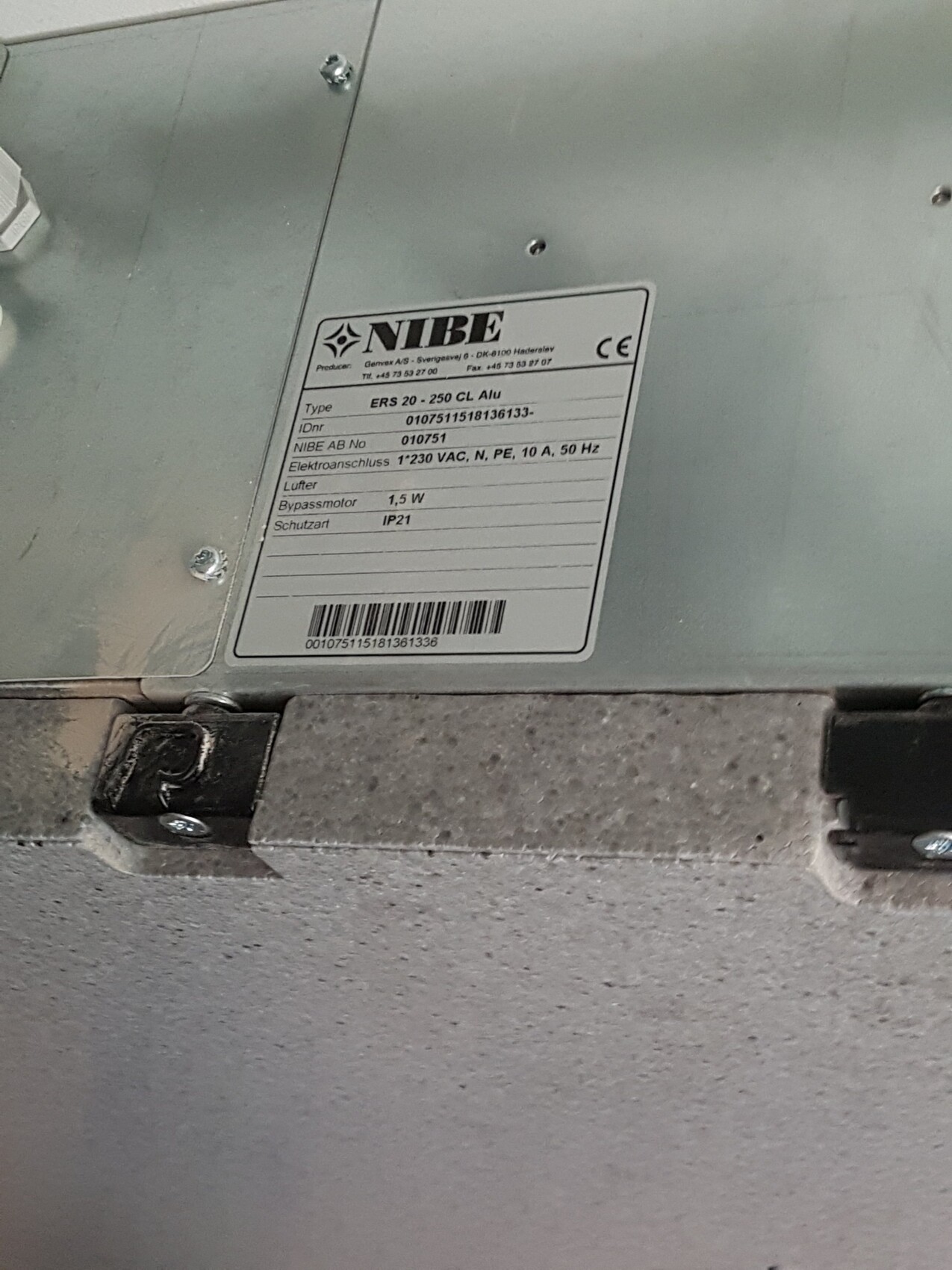

I have now found the label with the manufacturer’s name
Metallic home technology device with NIBE label and visible screws.
