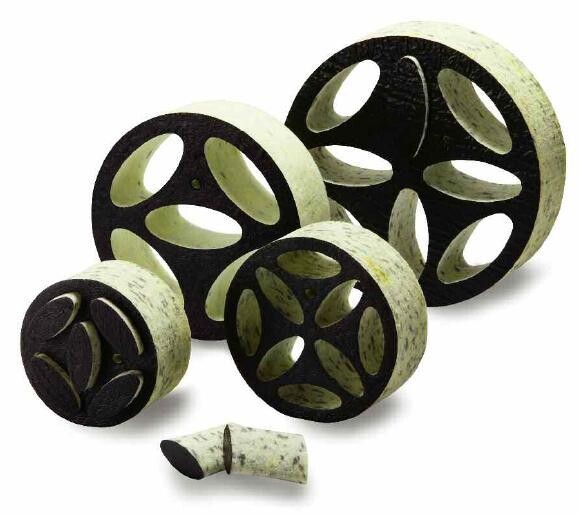

I wanted to give a quick update.
Someone from the company came by and inserted foam plugs about 10cm (4 inches) thick into all the supply and exhaust air vents. He said these are sound dampers. And it really is much better now. I still need to test the impact on conversations with my husband tonight. But the loud noise from the system is now hardly transmitted at all.
Do you think these plugs could negatively affect ventilation? According to Alex85’s calculation, the system is already operating at full capacity.
Yes, exactly those devices are installed now. The system is set to 40% capacity in "normal operation." I assume that this is actually not enough, which is why the air seems to be used up or is. But when it runs at 100%, it still makes a loud noise in all the rooms. The installer said you never really need 100%, only if you have a party or something like that…
