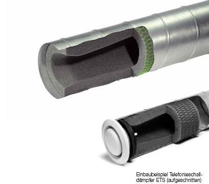

Additional telephone line sound attenuators need to be installed, or different ones like these here:

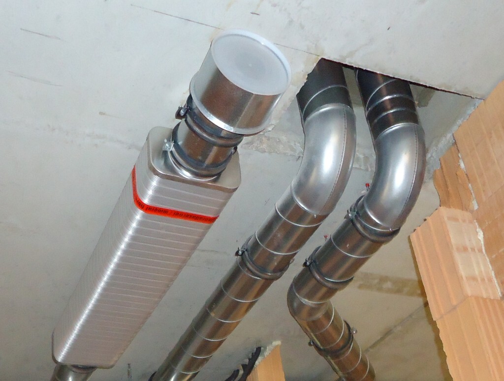

Alternatively, as a last resort, telephone line sound attenuators must be placed between the rooms; these are usually flat and look like this:
By the way, we also installed the wiring with spiral-seam ducts (but parallel), and there is no noise at all.
