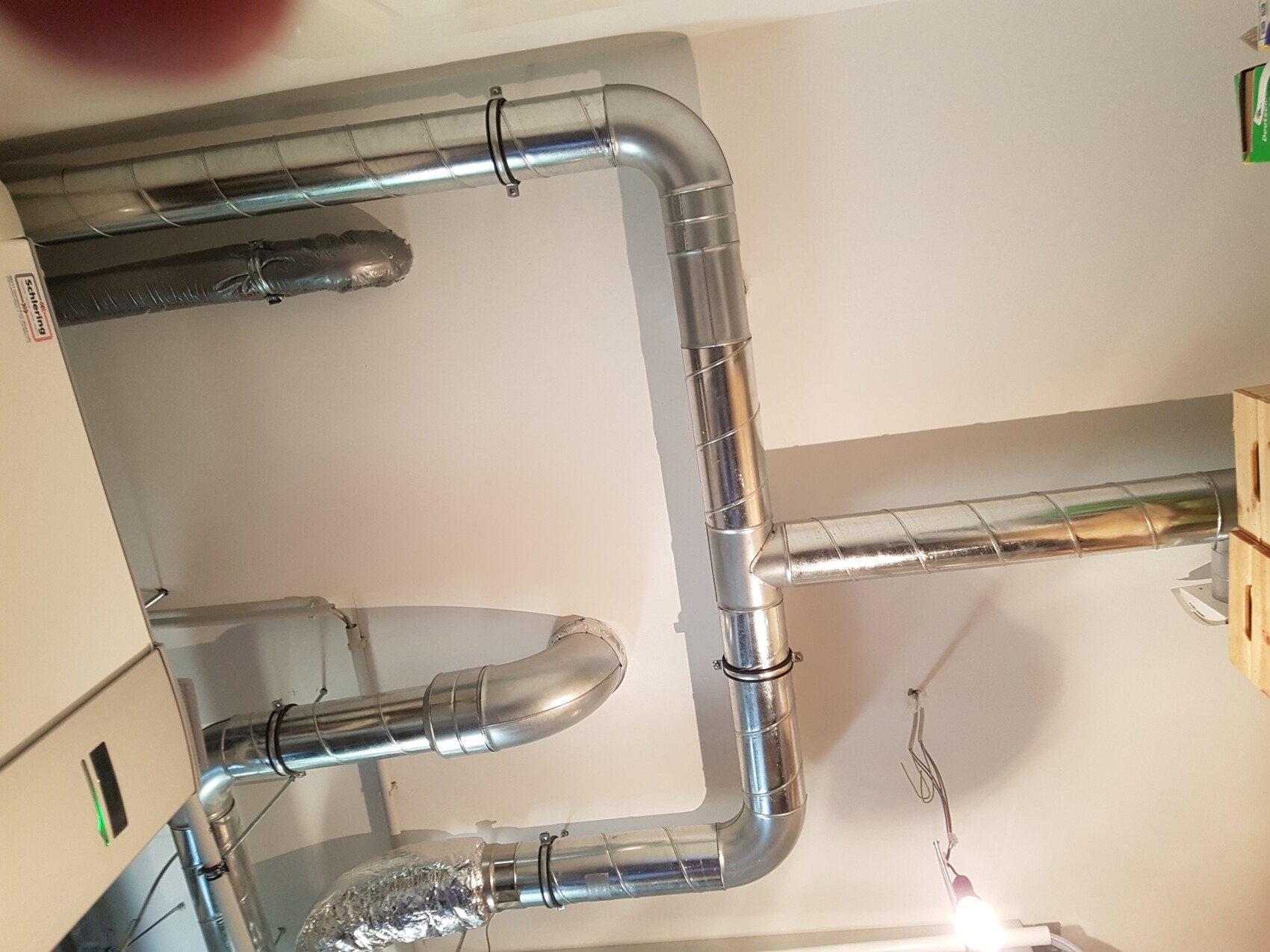

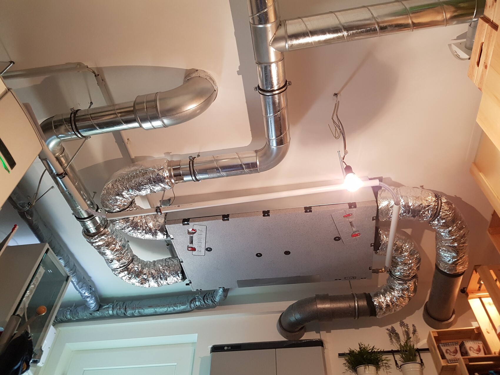

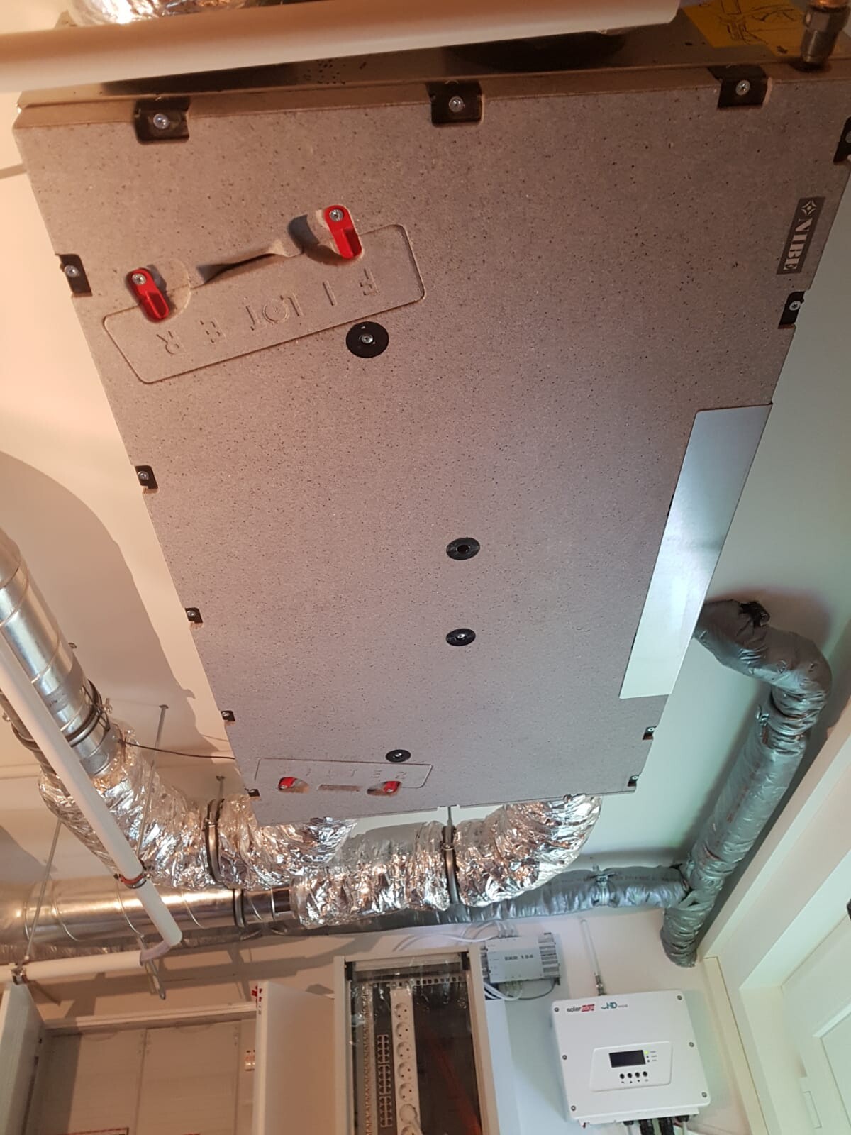

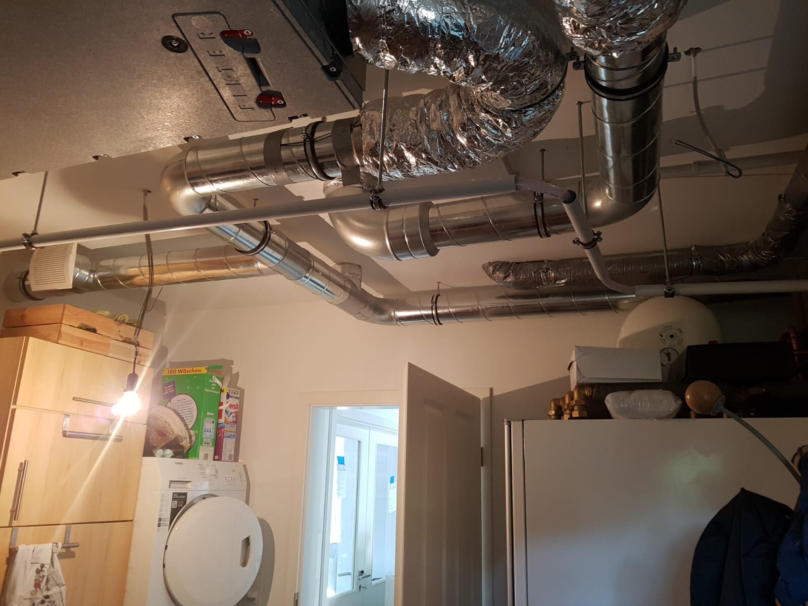

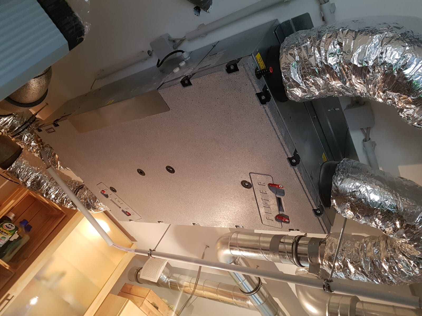

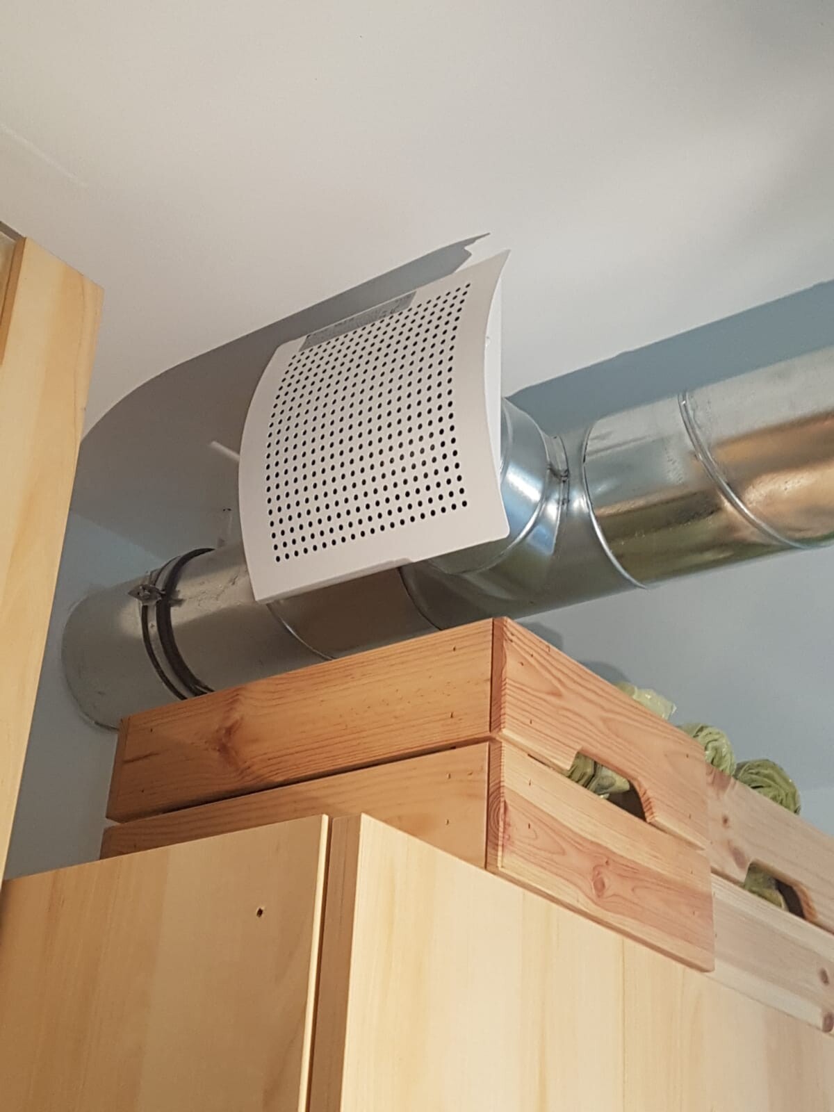

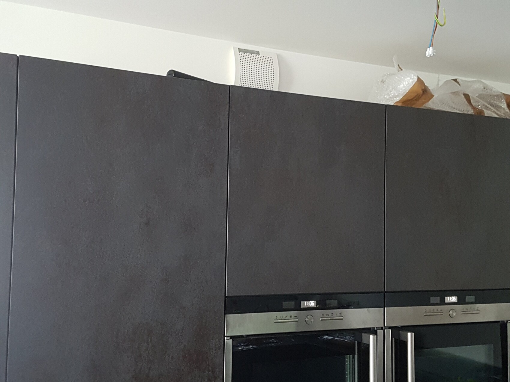

First of all, thanks for all the replies. Yes, it really is strange. But the noise definitely comes through the ducts.
It is very loud through the exhaust vent, every word audible. Even in the upstairs bathroom it's still clearly heard. The supply air carries the sound muffled. But of course, it's quite annoying when the children's rooms are not quiet. And the humming of the ventilation system is also transmitted from the utility room into all other rooms.
Here are some photos: the first one shows the exhaust vent in the kitchen. The others are from the utility room.
The exposed metal pipe alone conducts a significant amount. In the commonly used systems here, the plastic is embedded in concrete or under the screed.
I believe the flexible ducts at the unit have sound-dampening properties, but as mycraft mentioned, that is probably not enough.
