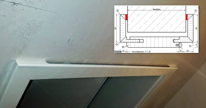

Hallways cleared. But is the exhaust air from the living room (and all bedrooms) supposed to be removed only through the door gaps?That’s exactly how it’s done. However, the living room is ventilated through the kitchen.
For soundproofing reasons, I will mill out the door frames in all rooms instead of relying on air flowing over the door gaps.

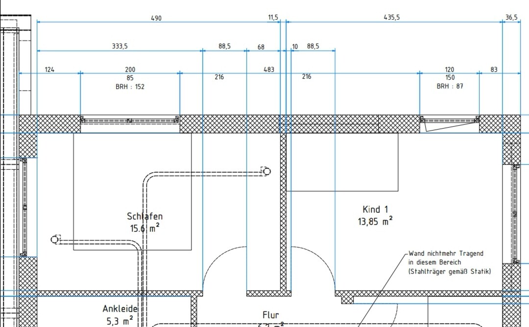

I’m still considering how to improve sound insulation between the child’s room and the bedroom. Currently, there is only an 11.5cm (4.5 inches) lightweight concrete block. Does anyone have suggestions? A drywall partition with an air gap, acoustic insulation wool, and gypsum board? A 24cm (9.5 inches) lightweight concrete block? Two layers of 11.5cm (4.5 inches) blocks with an air gap or mineral wool in between?

I’m still considering improving the sound insulation between the children’s room and the bedroom. Currently, it’s just an 11.5cm (4.5 inches) lightweight concrete block. Does anyone have any suggestions? A stud wall with an air gap, acoustic insulation, and drywall? A 24cm (9.5 inches) lightweight concrete block? Two layers of 11.5cm (4.5 inches) blocks with an air gap or insulation in between?17cm (6.7 inches) sand-lime brick wallSimilar topics
