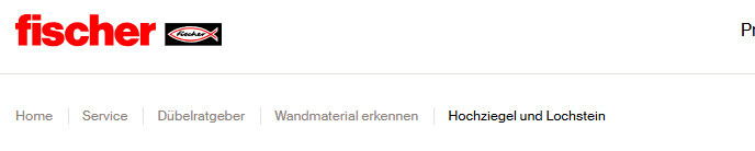

nordanney8 Jan 2026 14:45Felix571 schrieb:
It would be great if someone could help me out. You can check with the usual suspects, for example with
nordanney schrieb:
You can check with the usual suspects. For example, at
