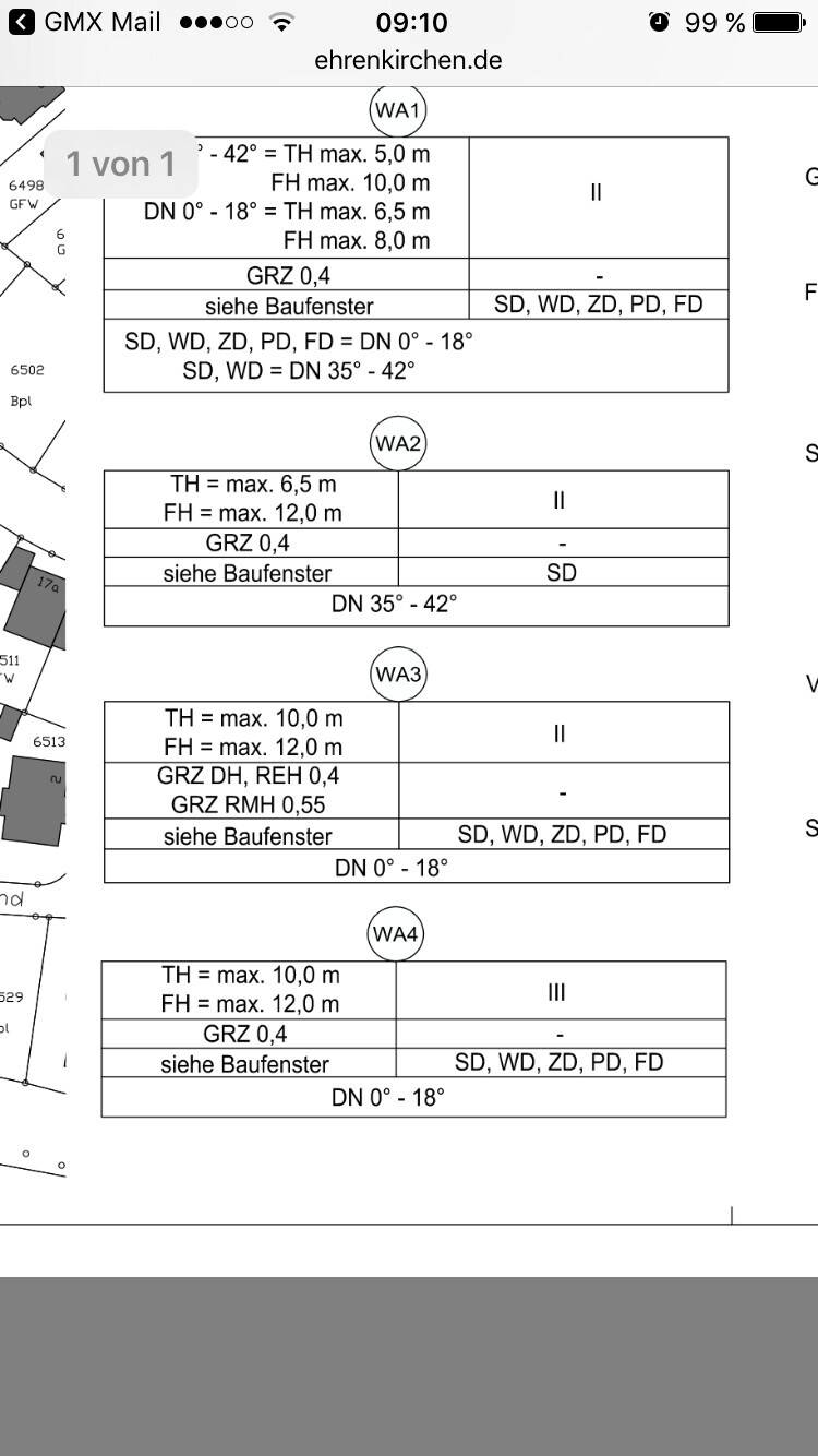

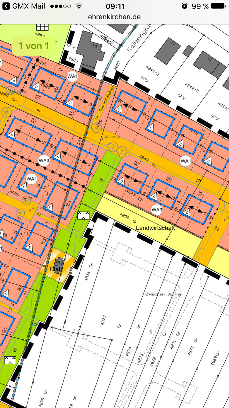

michi216
26 Mar 2017 09:18
Good morning,
What made us and the architect suspicious yesterday is the following. In WA 2, two full stories are allowed with a building height of 6.5 m (21.3 ft), which seems reasonable. However, in WA 3, there are five plots with townhouses and semi-detached houses that allow a building height of 10 m (32.8 ft), but still only two full stories.

11ant26 Mar 2017 15:28
michi216 schrieb:
In WA 2, two full stories are allowed with a ridge height of 6.5 m (21 feet), so that fits. Now, in WA 3, there are 5 lots [...] that allow a ridge height of 10 m (33 feet), but still only 2 full stories. What purpose do you see here?
The one I see at first glance, and you will too after some more practice reading plans: with the same 12 m (39 feet) ridge height, especially with shed roofs, a roof pitch of 18° logically results in a higher eave height than a pitch of 42°.
michi216
26 Mar 2017 15:57
I understand that so far. But if I build a shed roof with an 18-degree slope, I am still only allowed to build 2 full stories, right? In that case, I would have a room height of 5 meters (16 feet) if I make full use of the building height limit of 12 meters (39 feet), correct?
11ant26 Mar 2017 16:09
"Or" is correct 🙂
Both measurements are maximum values. The eaves height is sufficient for two stories without sloped ceilings. In the attic, with a house depth of 14 m (46 feet), you would reach about 4.5 m (15 feet) at the ridge if you use the full 18° roof pitch, resulting in a ridge height of approximately 11 m (36 feet). As Uwe Seeler said so nicely in the C-Tel commercial: "my wife did the math." 🙂
