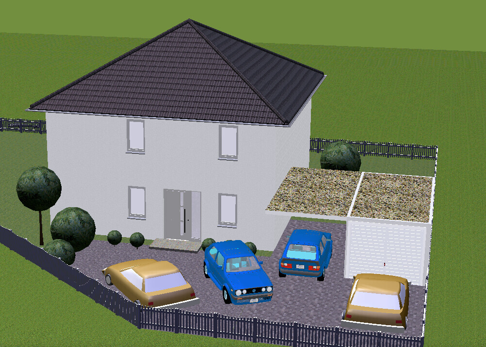

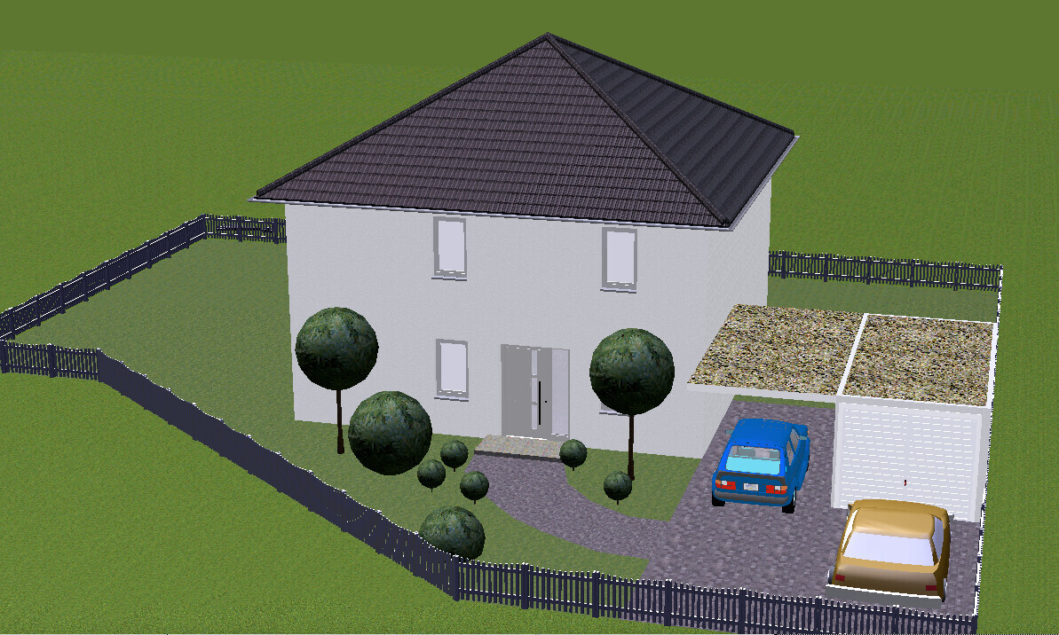

Gini_86
So, I quickly put together an exterior view, assuming the entrance faces east and the long driveway is omitted. You can tell my software is a bit outdated from the vintage cars
once with a nice front garden
, once with a courtyard suitable for lots of guestsWow!!!! Thank you so much for your effort!!!!
Amazing
Gini_86, convMessage: 34766, member: 47630 schrieb:
Hi, first of all, thank you very much for your drawing.
You say rotated by 90 degrees? Then it won’t fit anymore with the terrace facing south, right?You can place your terrace anywhere. You just need a patio door leading outside. It’s better to have it in the kitchen or dining area rather than in the living room. A terrace usually belongs next to the kitchen.
Maybe it should be made very clear to you: the house will be built exactly the way YOU want it, as long as it complies with the zoning regulations.
It is your decision where everything is placed and how the rooms are arranged.
You can plan your terrace anywhere within the building envelope. It does not have to be where the architect drew it.
I think you might not realize this.
It is your money that you are spending and will have to repay to the bank with interest. So consider carefully what makes sense and what doesn’t. You are the ones who tell the architect where everything should go.

So, I quickly put together the exterior view, assuming the entrance is on the east side and there is no long driveway. You can tell my software is a bit outdated by the old cars
, once with a courtyard for plenty of visitors What is the name of the software? Can you recommend something free?
Thank you!
