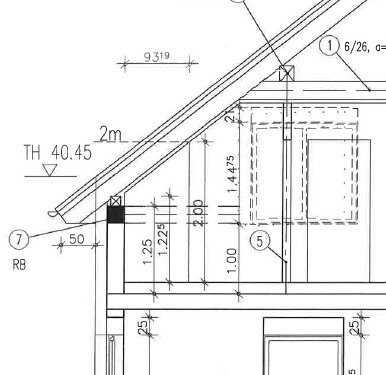

Exactly, it ends at 2 m (6.6 ft) now, and I would have preferred going up to 2.20 m (7.2 ft) rather than considering a wider span. Mainly because that’s easier than adjusting the rafter spacing.
I agree with you, windows with a height of 1.4 m (4.6 ft) would also fit, provided the roof window starts directly at the bottom purlin. According to my calculation, that would be about 1.5 m (5 ft) in length up to a height of 2.2 m (7.2 ft) with a roof pitch of 38°.
However, I’m not sure if that’s feasible or if it might look awkward inside when the roof window starts right at the sloping wall at the bottom. Usually, you leave a gap of 10-20 cm (4-8 inches), right? Then it would become quite tight again.
Attached is the cross-section of the house. It’s a very good idea to optimize the use of space.

chrisw81
19 Apr 2019 18:57
I am also considering making the windows 140 cm (55 inches) long instead of 118 cm (46 inches). If they start just above the knee wall at 1.25 m (4 ft) high, they would end at about 2.2 m (7 ft 3 in). However, I’m not sure if that would look too overwhelming...
