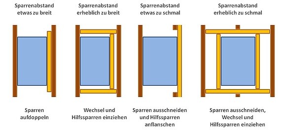

Could you maybe remove a rafter and flange it on, Flange it? To what and how?
Flange on? ? ? – what, onto what? This means you remove a section of the rafter and place a slightly longer one next to the resulting gap. This way, you gain the width of the rafter (about 6cm (2.4 inches) in my case). See the image "Rafter spacing slightly too narrow"
Mottenhausen4 Apr 2019 21:09I would have seen it as a kind of "change" as well, but the sketch is quite informative about the different types.
Without battens to clamp this auxiliary rafter in place, it seems like a poor construction to me. Torsion is practically inevitable. This might still work with laminated veneer lumber, but with solid wood, it’s a joke.
Without a counter batten to secure this auxiliary rafter, it seems like a botched construction to me. Warping is practically inevitable. This might be acceptable with laminated veneer lumber, but with solid wood, it’s a joke. You’re probably right. I think there are only two options: either a proper beam transfer or trying to space the rafters a few centimeters further apart—if the structural engineer and the carpenter allow it.
