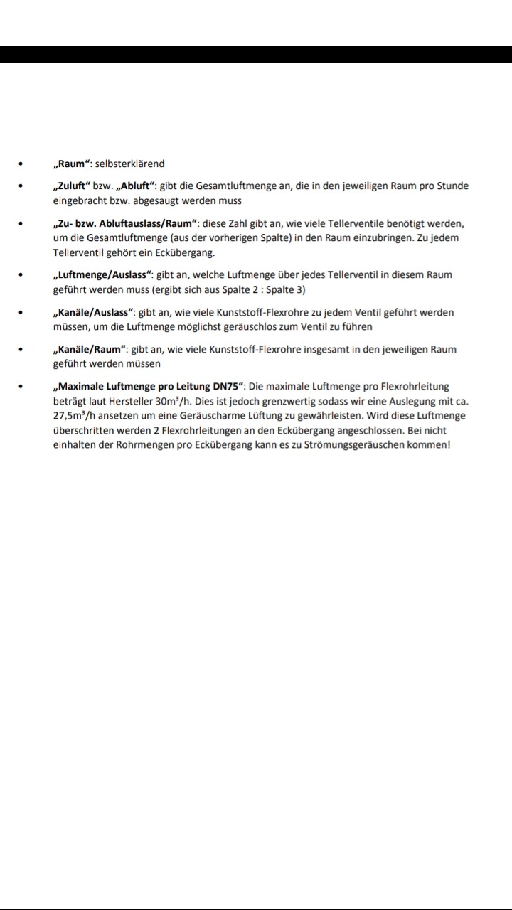

tumaa
6 Jun 2019 22:21
See the last section ..... was still in the attachment.
Document with text list on room air volume, supply air, room ducts, and ventilation
