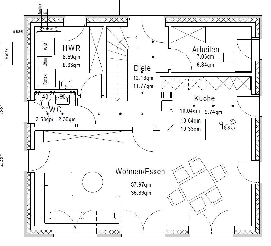

So the plan is basically as follows. In the hallway, the spots will be recessed centrally in the ceiling. Spacing is 70–80 cm (28–31 inches) between individual spots. The LED spots are from activled and have a beam angle of 120 degrees.
In the guest bathroom, there will be 2 spots also recessed centrally in the ceiling, plus an additional wall light above the mirror. Without the wall light, you would be looking into the mirror without any lighting, since the ceiling light mainly illuminates the back of the head.
In the kitchen, 3 spots will be recessed centrally in the ceiling. For the countertop lighting, there will be separate under-cabinet lights below the wall cabinets. Above the kitchen island, there is a range hood that also has its own lighting. Only to the left of the sink are no wall cabinets, so there might be some brightness issues there, hmm.
Attached is my ground floor plan.

Knallkörper12 Apr 2017 12:48My first impression is that you have generally planned too few lights. The range hood will not illuminate the entire kitchen island, so I would add at least one on each side of the range hood OR three in a row behind the range hood facing the living room, above the countertop, with a steep beam angle. It is almost pointless to only light the center of the kitchen. Are there wall cabinets above the sink? In the hallway, the distance to the doors is too large, and in front of the main entrance, I would distribute two lights across the width.
G-Star198812 Apr 2017 13:17No wall cabinets above the sink, I also see a problem there.
So, having one cabinet on each side, left and right next to the range hood, would be worth considering. Not enough lighting in the hallway? We looked at many model homes. There, the hallway was usually equipped with only one spot light, and the spacing was about 1 to 1.2 meters (3.3 to 4 feet).
Knallkörper12 Apr 2017 13:21You will be standing in the dark at the sink.
