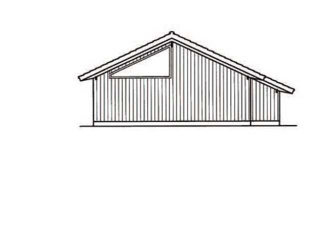

On the right (eastern) side, there is a triangular window from the eaves up to the gable, which is fixed. The other window facing north is still variable in width and position.

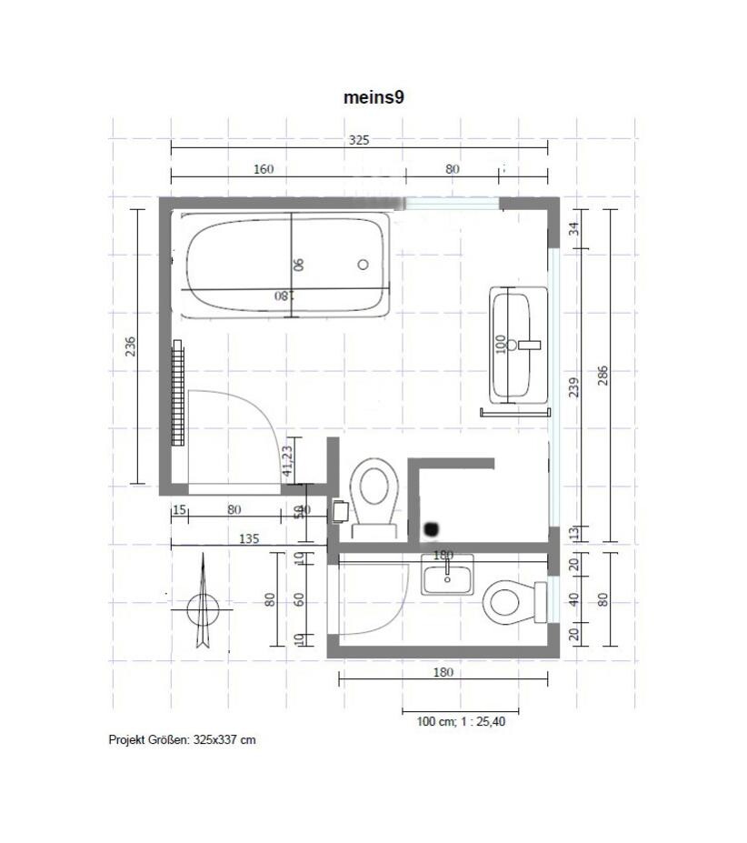

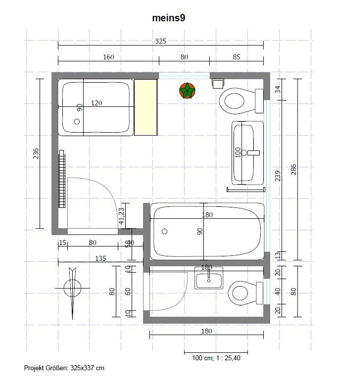

Bauexperte3 Jan 2012 17:57Hello Peter,
The triangular window is not floor-to-ceiling, correct? And – if I understand your view correctly – is the guest toilet window missing?
Attached are two quickly sketched proposals; in both versions with the floor-level shower, no glass or sliding door is needed because the water doesn’t splash far; a simple bath or sauna towel is sufficient. On the north side, the second window makes sense in the second version – I would design both as continuous strips of daylight.
A guest toilet is always useful – even for two people, they often have the same needs. And – speaking for myself, I don’t want a stranger using “my” bathroom 😉

and thank you very much for your replies and suggestions. The deciding factor for having a guest toilet was indeed the idea that two people might need to use the bathroom at the same time, and in that case, a second toilet is simply practical (even if the situation probably occurs rarely) – in a way, also a form of luxury.
The triangular window is not floor-to-ceiling; it extends from the eaves to the ridge. The guest toilet window is not yet shown in the drawing. Thanks also for the two sketches – I thought I had considered all possible layouts, but these two are new and worth thinking about!
