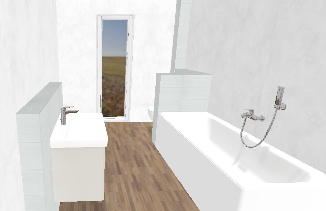

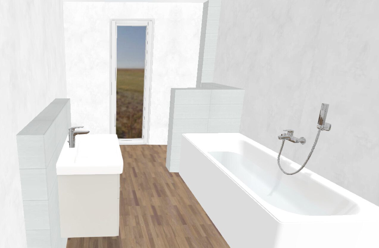

Here is the half-height version without a built-in enclosure around the bathtub.
80 cm (31.5 inches) long half-height wall:
Bathroom with sink on the left, bathtub on the right, door to the outside in the background.
95 cm (37.4 inches) long half-height wall:
Bathroom with bathtub, sink, shower fixture, wooden floor, door to the outside.
If a built-in enclosure is added around the bathtub, it is roughly 90–95 cm (35.4–37.4 inches) deep. On the opposite side, the sink with the pre-wall installation is about 65 cm (25.6 inches) deep. The room is 240 cm (94.5 inches) wide. Is 80–85 cm (31.5–33.5 inches) of passage not quite narrow?
danixf
21 Feb 2020 15:02
Oh, I completely missed that on the floor plan.

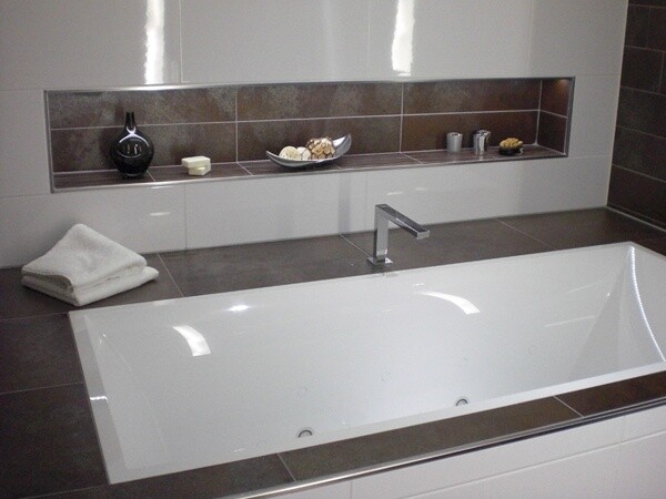

I would go with the flush option. But that’s really just a matter of personal preference. Definitely avoid a frame around the bathtub.
80-85cm (31-33 inches) is already tight when multiple people are in the bathroom. I think you can manage, but it’s definitely avoidable here.
I’ve attached a photo of a storage niche to show what I mean. Of course, not in the same dimensions.
